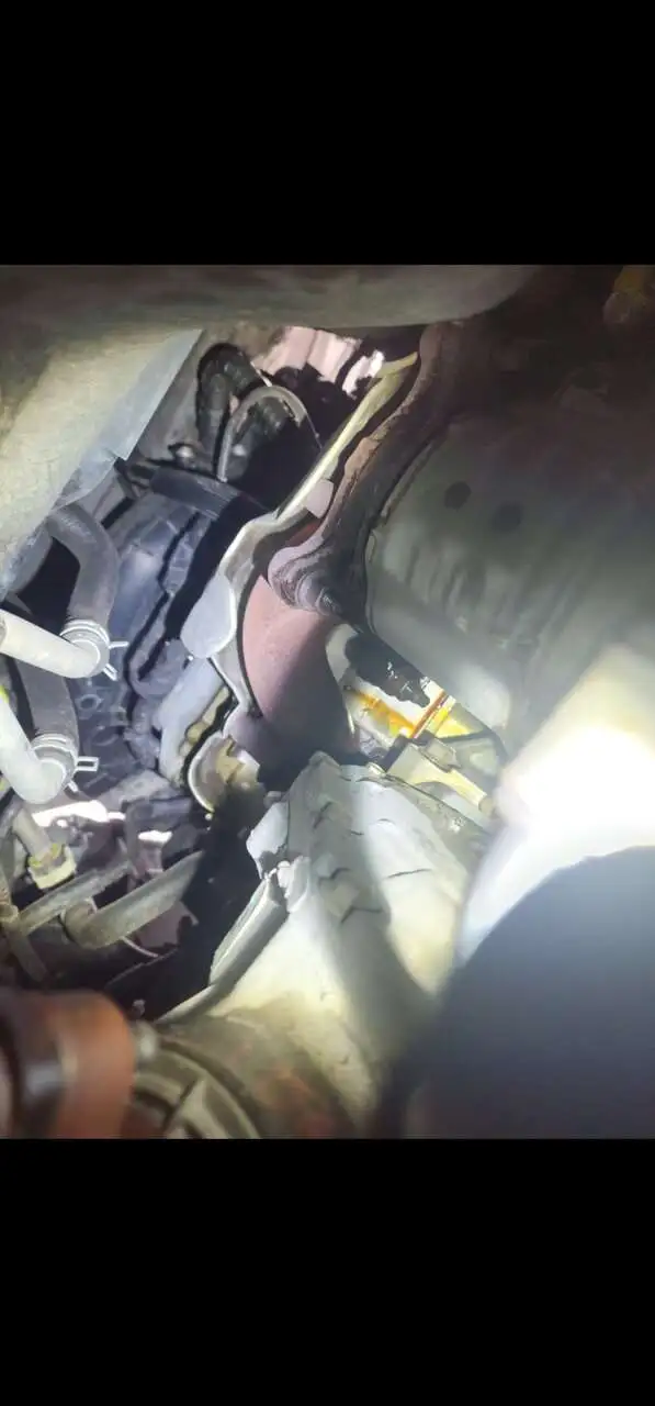

2011 cx9. Changed coils and plugs. Ran worse after. Noticed oil puddle in driveway. There is a factory hole on the head just below the exhaust manifold that oil is flowing out of. What is it and how do I fix it. Thank you all in advance. I have a picture of the culprit but I cannot get any pictures to attach to this post

Awesome man thanks. Fortunately I was able to get it figured out. Valve cover gasket. Didn't know it would leak down out of those rivet holes

@gavin6604 Did you say you found out u had a bad valve cover gasket after changing the ignition modules and spark plugs?
I'm having the same problem with that hole dripping oil after changing my plugs and ignition modules.
