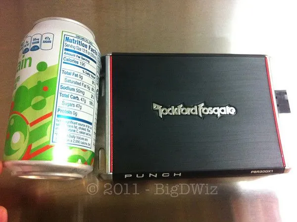

Bought the Rockford Fosgate for my mids and highs, planning to change out the front and rear doors with Kickers s68 6x8 and will be powered by this Rickford specs is 75watts per channel but tested sheet inside says 94watts per channel woo hoo. will add pictures when done

ok I finally upgraded my whole system
i kept the Bose factory 10 channel amp, this is running the 5 factory tweeters
I upgraded the following
front doors with Cadence FX8M4 (4 ohm) 8" 250 Watt MidBass Driver Midrange Car Speakers
http://www.ebay.com/itm/ws/eBayISAPI.dll?ViewItem&item=350524359506&ssPageName=ADME:L:OU:US:1123
Rear Doors
Cadence XM-68HC Xenith 6.5" 300 Watt 8 Ohm Loud Mid Range Car Audio Speakers
http://www.ebay.com/itm/ws/eBayISAPI.dll?ViewItem&item=300662719691&ssPageName=ADME:L:OU:US:1123
I powered these with Rockford Fosgate PBR300x4
I have Brutus BRZ1700.1D and Rockford Fosgate T1D212
I removed the Bose sub and put the 2nd Battery where the Bose used to be.
I'll take some pictures later on and post it here
