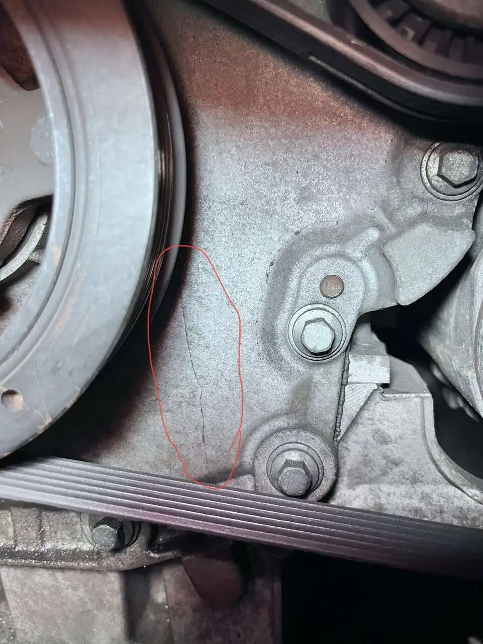

Well, low and behold I may have been looking too hard for spots to leak from, today while changing the oil, which did have some evidence of coolant, not too discolored though, I spotted a small amount of wetness where the power steering hose connects to the pump, took the tire and some plastics off to try for a better look and right in front of my face, I see this, not overly wet like an active leak, than again there’s no coolant in the res, it doesn’t run hot so, I guess I’ll just run it till I can’t no more..
