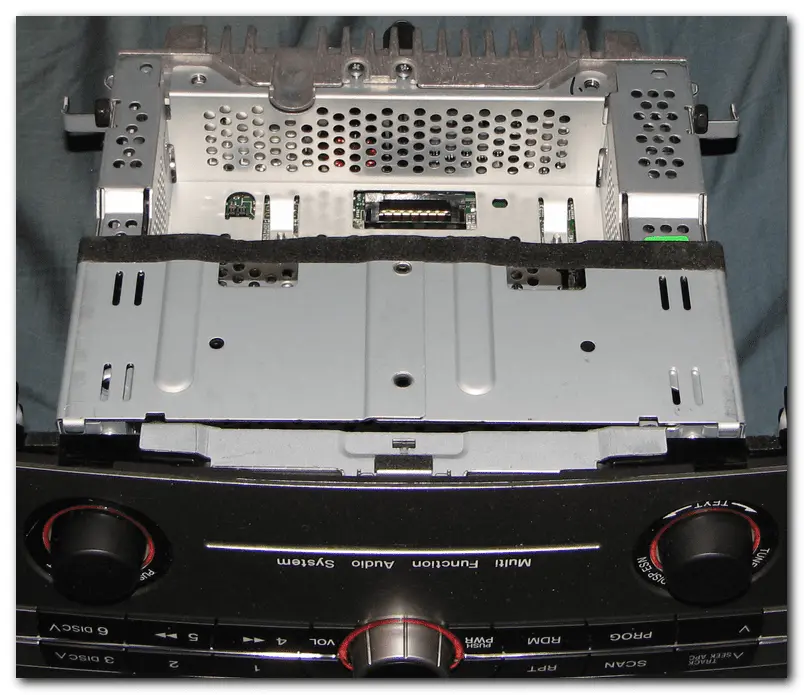

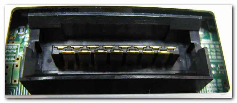

I'm not sure if these will help or not, but here's a couple shots of the bottom of my stock deck. I should note that the deck had been replaced by the original owner of the car (dealer/warranty/oem replacement). The car is an '07 MS3.
Thank you for the pics of your 2007 MS3 radio. Apparently, according to Bryan at Integration Solutions (AXXESS integration module seller) the 2008 does not have this Tape/MD port on the bottom. Here is his email reply:
Miguel
Thanks for writing us, Im sorry but I do not recommend this kit for your 2008 Mazda 3, they do not work with that radio. It lacks the MD port that was in the 2004-2007
I hope something comes out soon that works with through the SAT input port
Anything else just ask
thanks
Bryan
Wow, I didn't know the '08 models didn't have the TAPE/MD slot on the HU. In any case the AXXESS module doesn't work with the 2007 model. Let me clarify that. The AXXESS module doesn't work with Clarion HU's in mazdas, and clarion produces most if not all of the HU's in 2007 mazdas.
