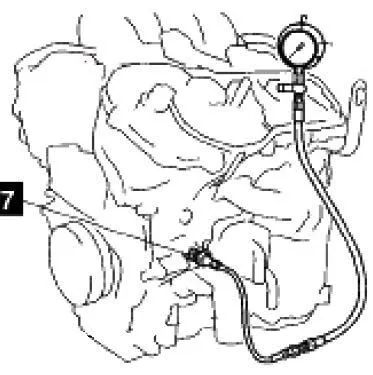

Haven't replaced one myself but the service manual is pretty clear about its inspection and replacement. This image from the manual shows the SST used to measure pressure being attached right where the switch is located. Should be fun to remove/replace.

Thanks. Yup that's it.

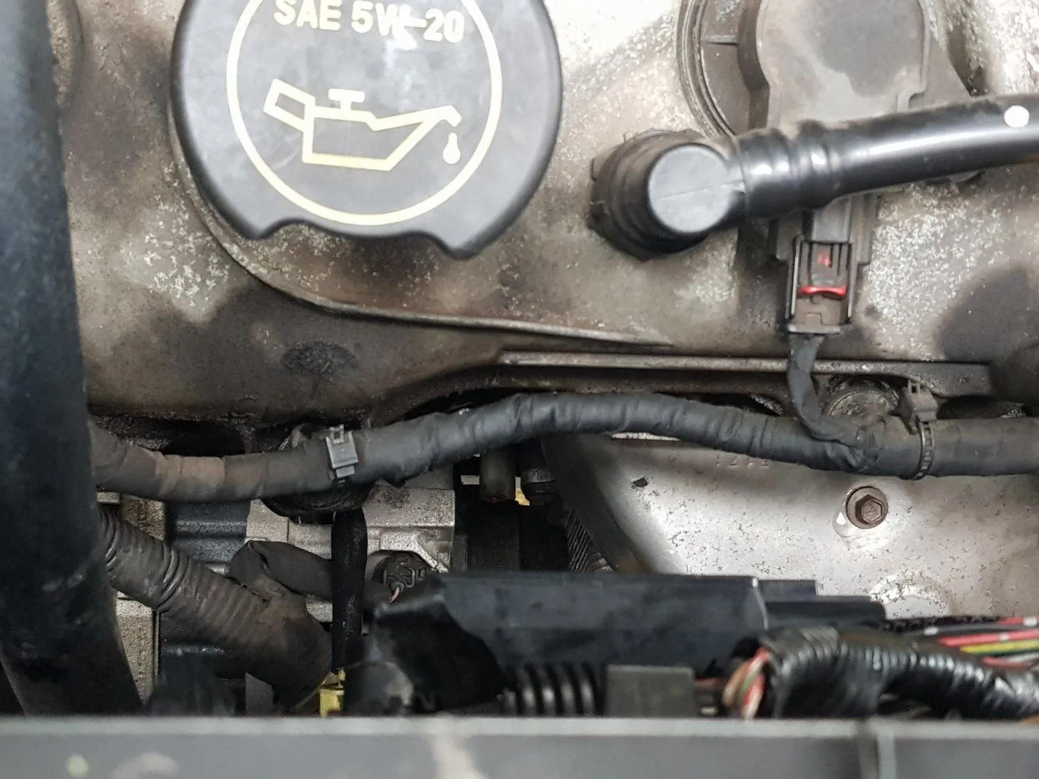

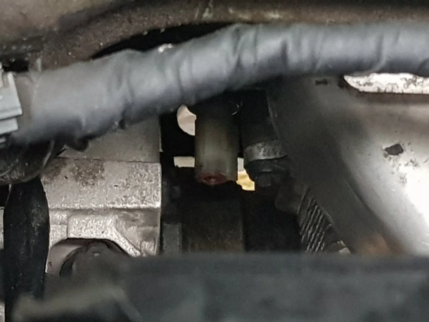

Good evening. I had the oil light on, but I realized that when I was driving over bumpi roads, the light went off. So, I replaced today 29Nov2020, the Oil Pressure Sensor Switch.
When replacing Oil Sensor Pressure Switch on Mazda CX9 2008, is not neccessary to drain the oil.
I had that question, so there it is. Yes, it will drain oil when the OSPS is removed, around 237ml of oil. So be prepared.
How I did it:
1. Sprayed some DW40 using a stick with a canal so it can run thru down the connector.
2. Removed connector with left hand. My nails helped me greatly. Over the radiator. Injector cable can be loosen a bit.
3. 21mm ratchet (the extended one), plus 2 small extensions, the big one was too large.
4. I had to put some cooking oil on my arms so my hands were able to go thru. But at the end the tools were oiled and it was a bit difficult to install the new one. I ended using gloves to tighten it up.
5. Applied thread sealant. And went under CX9 to install OSPS, for the first turn, I did the rest from above.
6. Make sure not to loose the rubber gasket from the old one. You will need it.
7. Make sure to leave the part where the connector secures the connection looking upwards. Mine was not all in, so, I installed the same way.
Some pictures from the location. That one was the new one. It was not all in so it can be visible.
