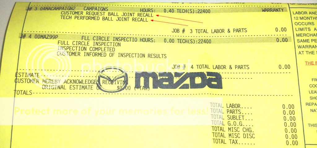

Just FYI, no big deal, took only about 1 hour to do the recall,
I have a 2013 CX-9 model and my local Mazda dealer didn't hassle me to show the phase 2 or 3 letter,
I just made an earliest available morning appointment and they just did it with no issues
Umm... I feel bad for that mechanic. .40 hours to replace 2 control arms & perform alignment? Screwed is what he is.
