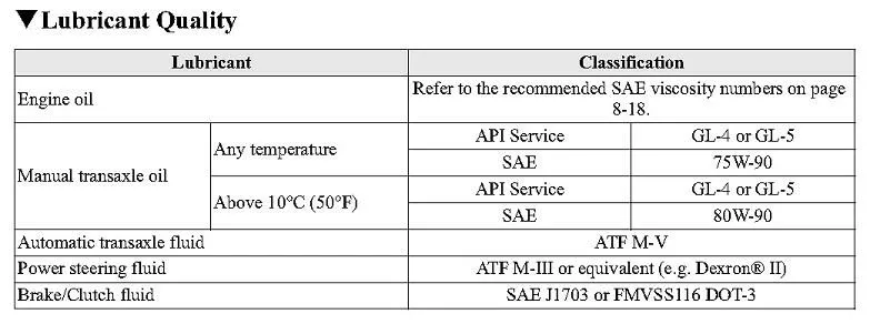

The power steering using automatic transmission fluid?
Yes, Mercon 3 or Dextron 2.
