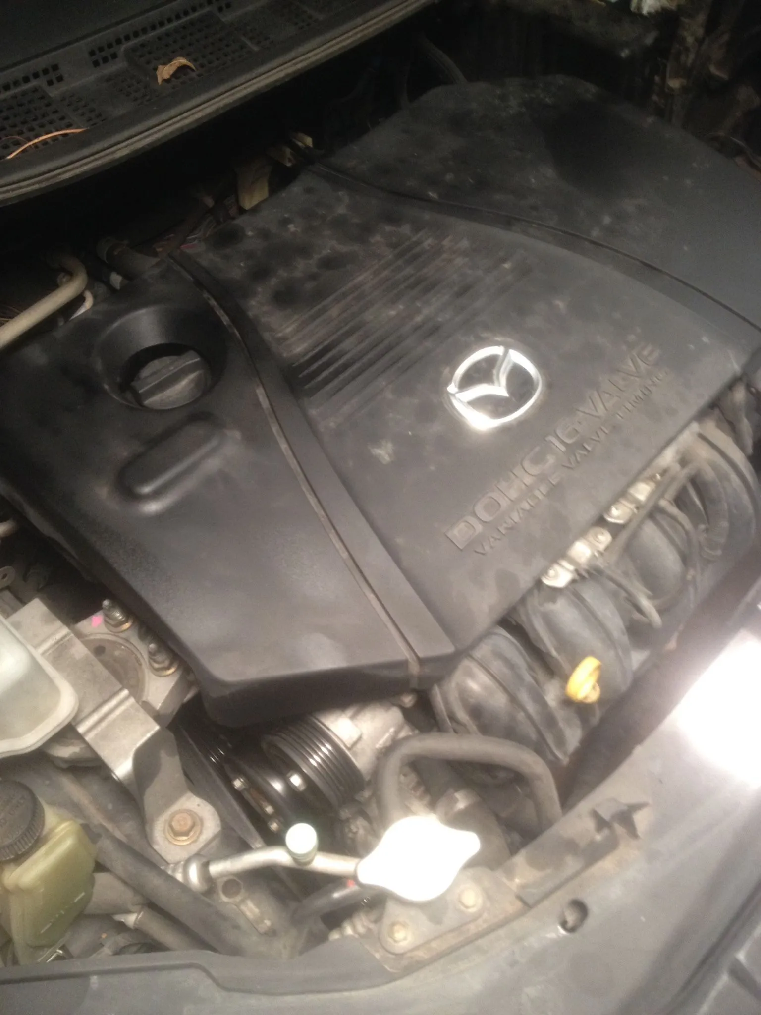

- Pull off plastic engine cover. (you may get away without this but it made it easier for me) Cover is held by 3 points. Pull on both corners nearest windshield and in the center of the cover closer to radiator. Should pop right off.

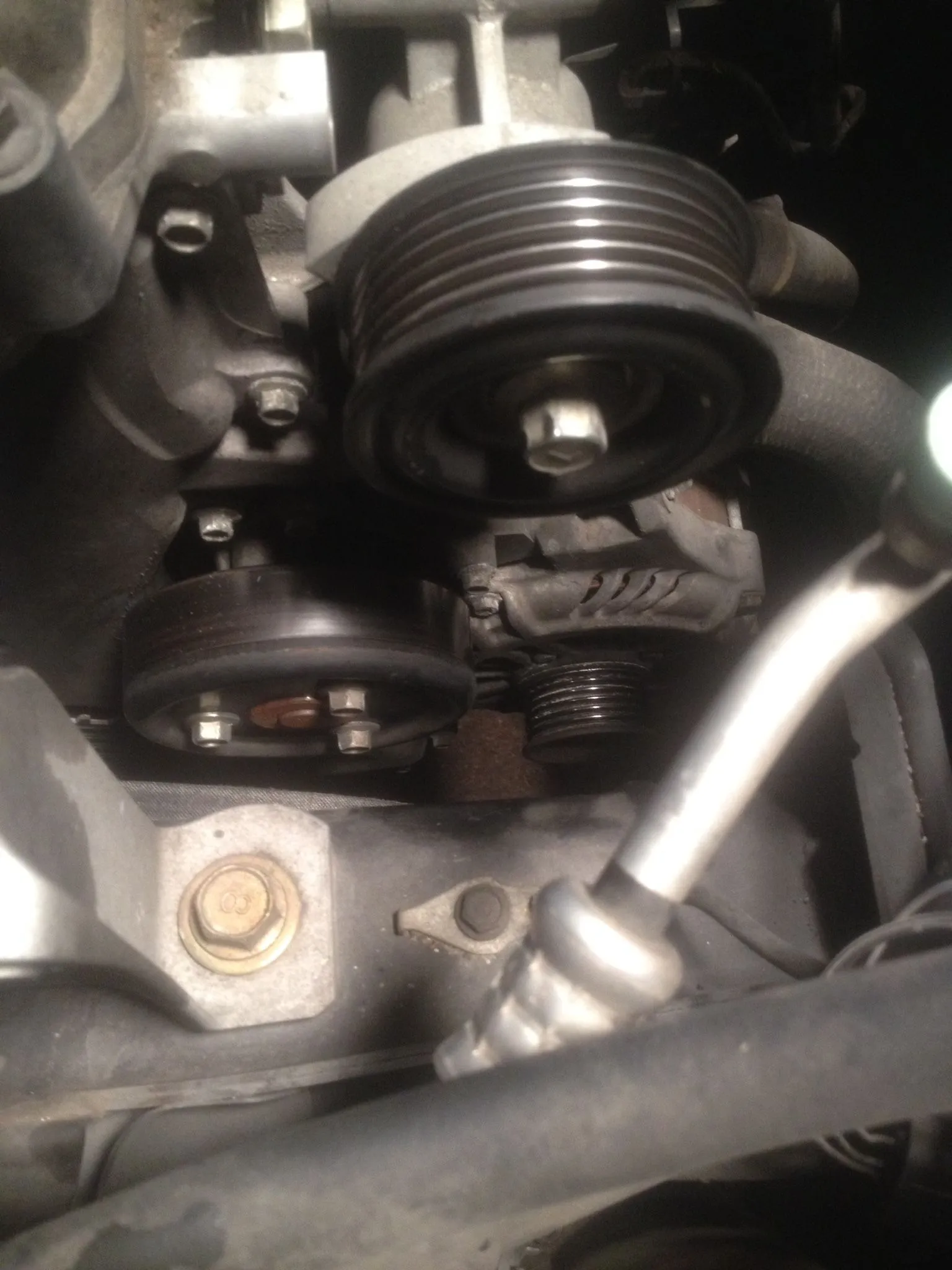

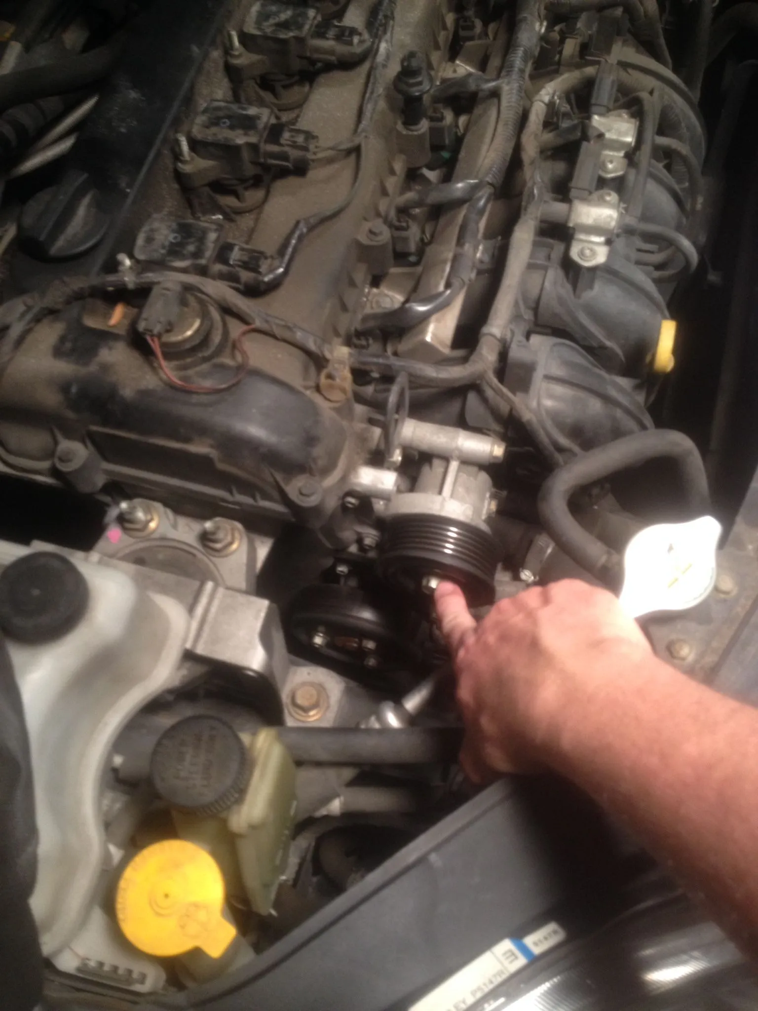

- Using a 14mm wrench/socket you will need to loosen the tension on the tension pulley on left side of engine. (This is maybe a 3" pulley for size reference.) Set socket to loosen and push pulley from front to back. Belt should loosen and you should be able to remove from pulley. Watch your fingers. Let the belt drop and don't worry about the bottom belt for the A/C.

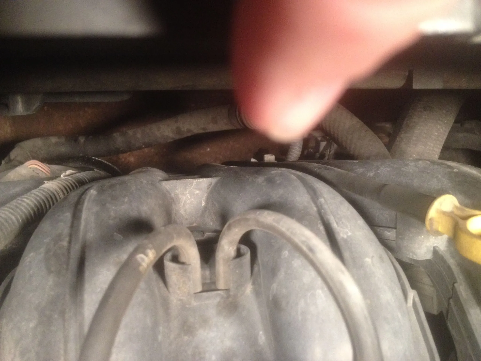

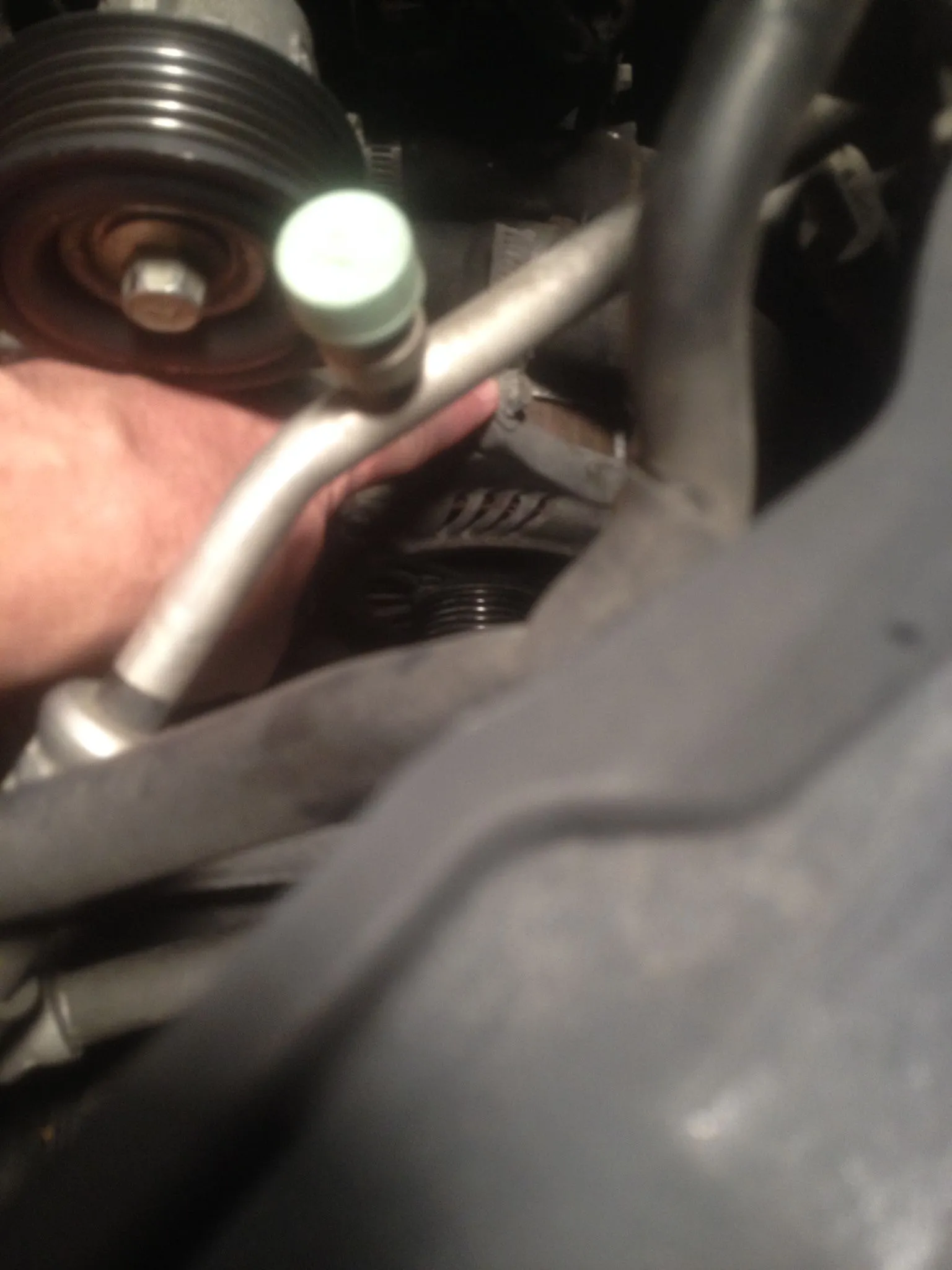

- There are '4' 12mm bolts that hold on the alternator. Bolt #1 is accessible from the topside of the engine. The head points toward the radiator. The other 3 may be accessible from the top if your hands are small enough. Mine are not. Loosen the top bolt almost all the way out. Leave it in so that when you take out the remaining bolts it does not fall. If you are by yourself take it out and be careful when you remove the rest so that it does not fall on your head. If you have a helper here it is easier.
- Crawl under and you will see bolts #2 & bolt #3 parallel to each other on the bottom of the alternator. If you look on the side closest to the engine above one of the bolts you will see bolt #4 tucked away above it. I had to use a socket with a reach bar for this one. There is not a lot of wiggle room to loosen or tighten this one. Be patient and it will come out/tighten. Take out the bolts #2 and #3, then do instruction 3&4 below for the wire connections, then take out bolt #4 on bottom side.
- While you are under there you will see 2 wire connections. One looks like a round bulb, the other just like a plug. The round plug opens up and inside of it is another 12mm bolt. This one came off pretty easily. Push it aside.
