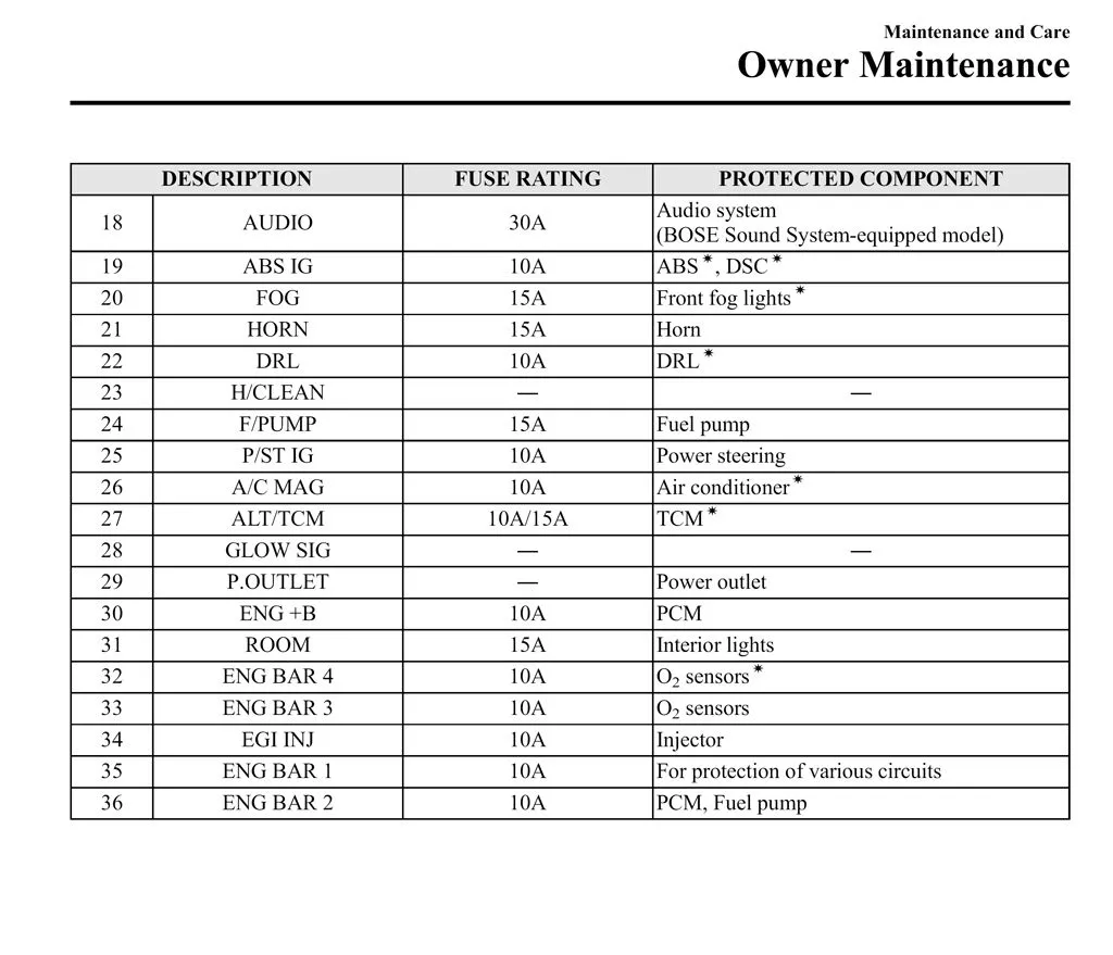

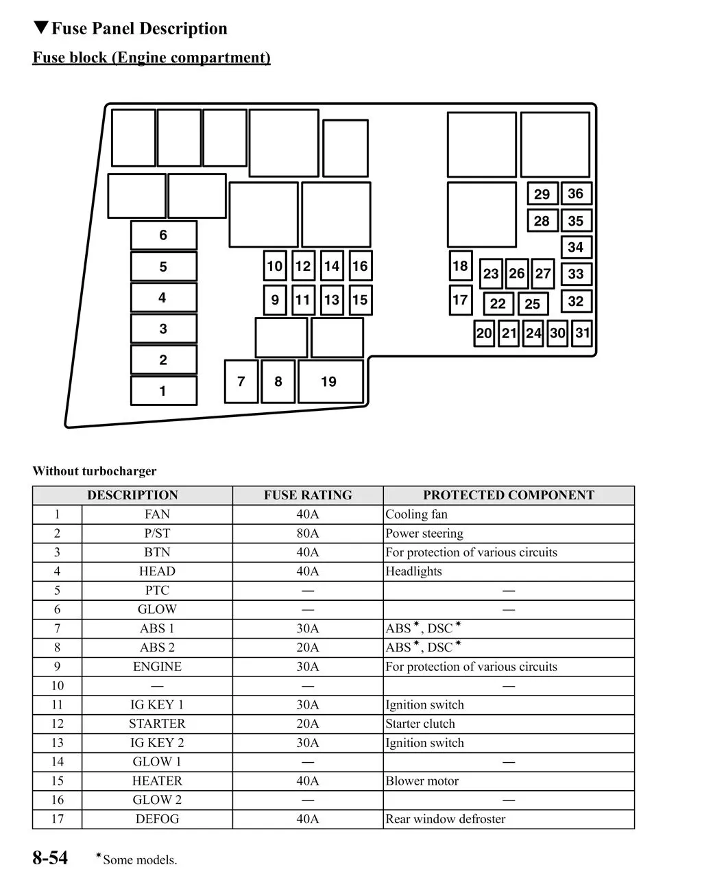

My cigarette lighter does not work for me to charge my cell phone. Where can i find the fuse for this? I did not see it under the hood, where is it and what type of fuse please? Thanks
Though I just realized you have a 2006... This might still include you.
This is from the 2007 Owners manual. Engine Compartment fuse box. Fuse 29 is labeled as Power Outlet.
