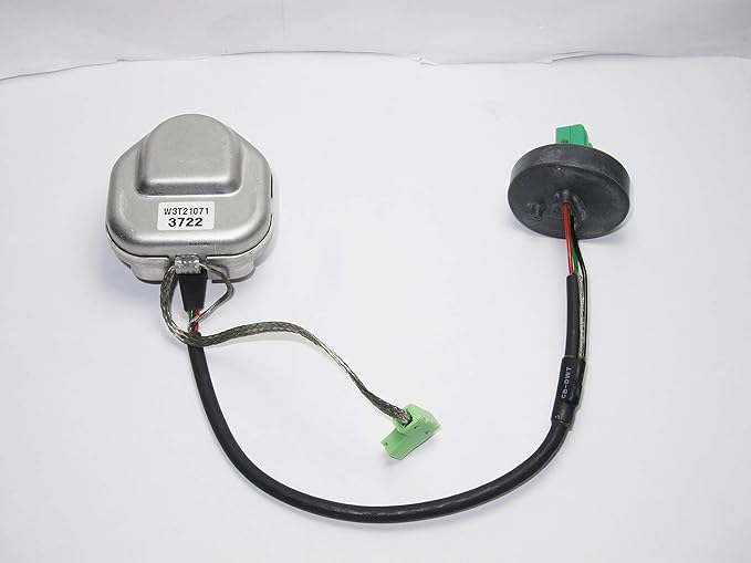

Well, it looks like my car came with Xenon HID headlights for the low beams, which is why things look different than the bulk of the replacement guides out there.
The unit I saw when opening the headlight dust cover looked like this:
It also appears that the bumper and headlight housing must be removed to replace the bulb.
Does anyone have any idea if it's possible to replace the HID light with an LED bulb? Is there a way to route the power cable? There's currently very poor visibility of the unit, so I can't tell how things are wired up right now. Next to the bulb area is an HID ballast, but I can't tell how power is getting to and from the ballast.
