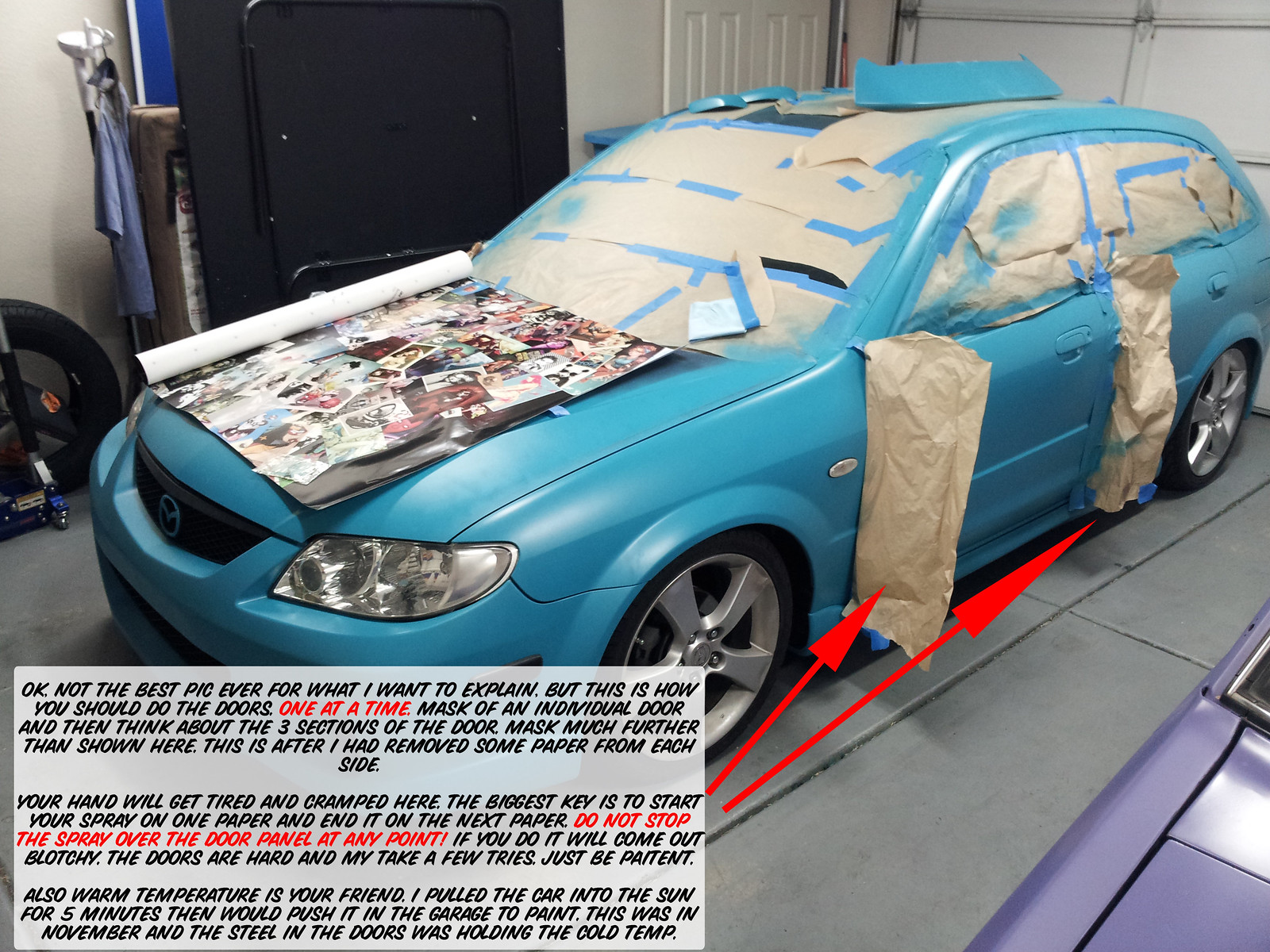

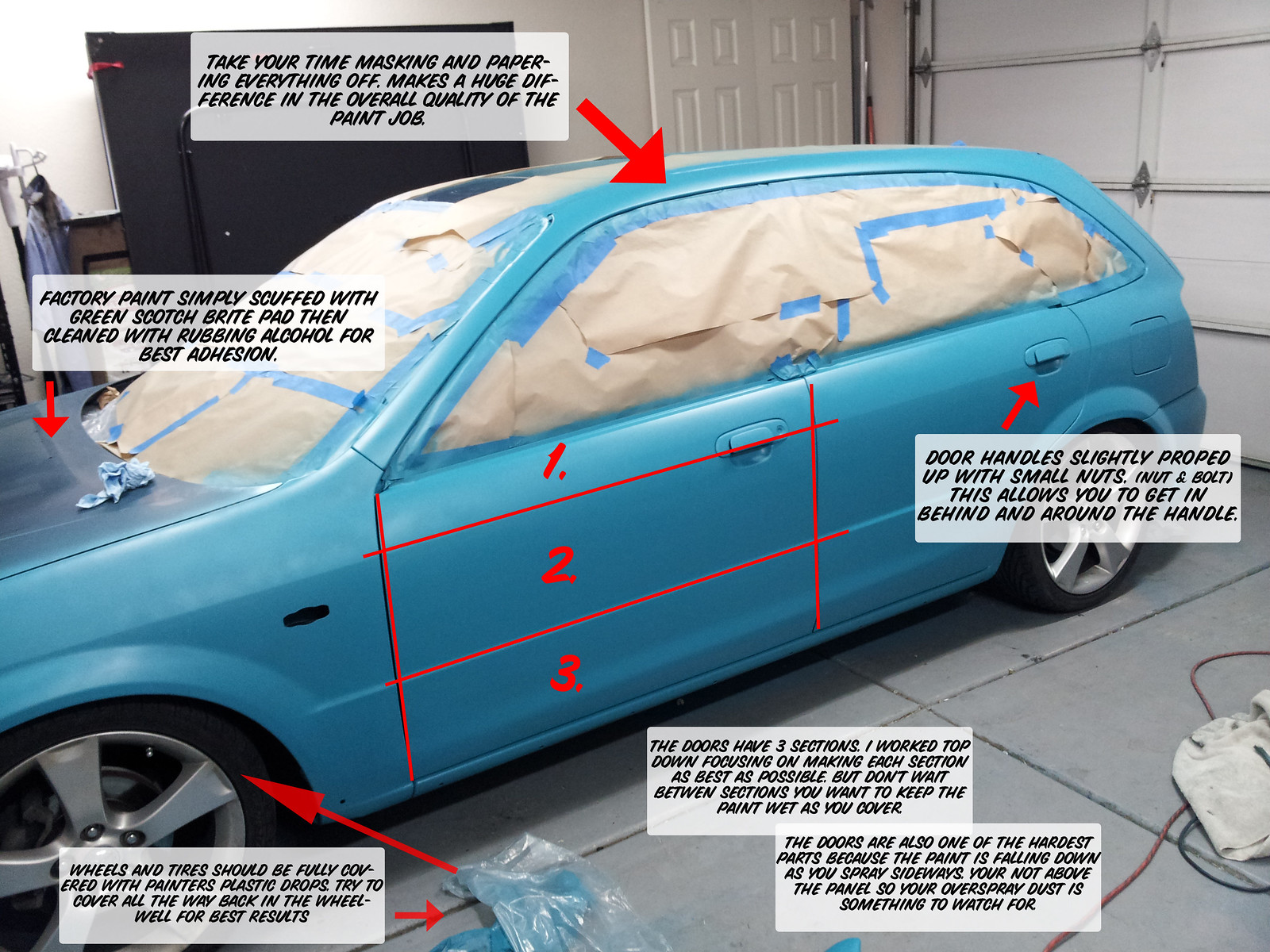

I have had a lot of people message and email me about the process for the painting so I am just going to add the info I sent them on here for any newcomers that may stumble across this thread.
The biggest thing overall is to just be patient. (also wear a mask or respirator because you will be blowing colored snot for a week if you don't)
To start just scuff the factory paint with green scotchbrite pad. You can buy the sponge kind at the store, but they are expensive and you are wasting one side with a sponge. I actually went to ACE Hardware and they sell 12"x12" squares of the material for like $1 that you can cut into smaller pads. After you scuff the clear so that the surface is fogy and not glossy, wash the car with water, dry it and then wipe it down with a rag with alcohol or other non-greasy solution to get any oils and stuff off the surface. This way you are spraying onto a good clean surface. Though I will say that I think you could spray this paint on chrome and it would stick just fine!
Don't waste your time trying to take the side skirts off. Almost every weird plastic clip holing them on will break from being old and dried out. I pulled the driver side, but said screw it for the passenger side. The both came out awesome.
The best way to paint the whole car is to "panel paint". Mask of a fender then paint just that fender. Mask off a door and paint just that door. Mask off the hatch and only paint the hatch... and so on. If you try to paint everything at once there will be streaks and poor paint coverage everywhere. This paint goes on heavy so you can get great coverage on the 1st coat, but may need a second on some panels.
The doors are hard to paint. The angle just sucks. I kept wishing I could turn the car on it's side to paint the doors. Actually I kinda tried to get a better angle by using a floor jack to tilt the side I was painting up a bit. DO LONG WIDE SWEEPS when painting the doors and make sure that you don't stop any spraying over the metal door panel you are painting. you don't want to create splotches.

HERE ARE A FEW PICS TO HELP TOO:
The 2 process pics above do not represent the finished product either. You may notice some splotchiness that was remedied with another coating before finishing.
