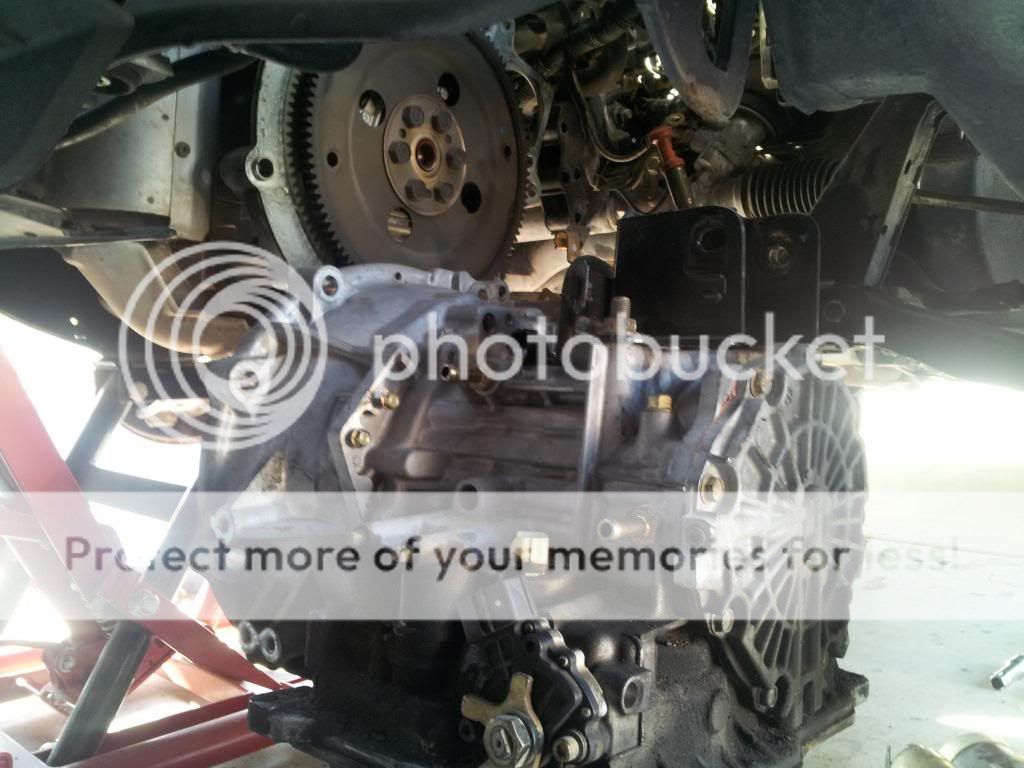

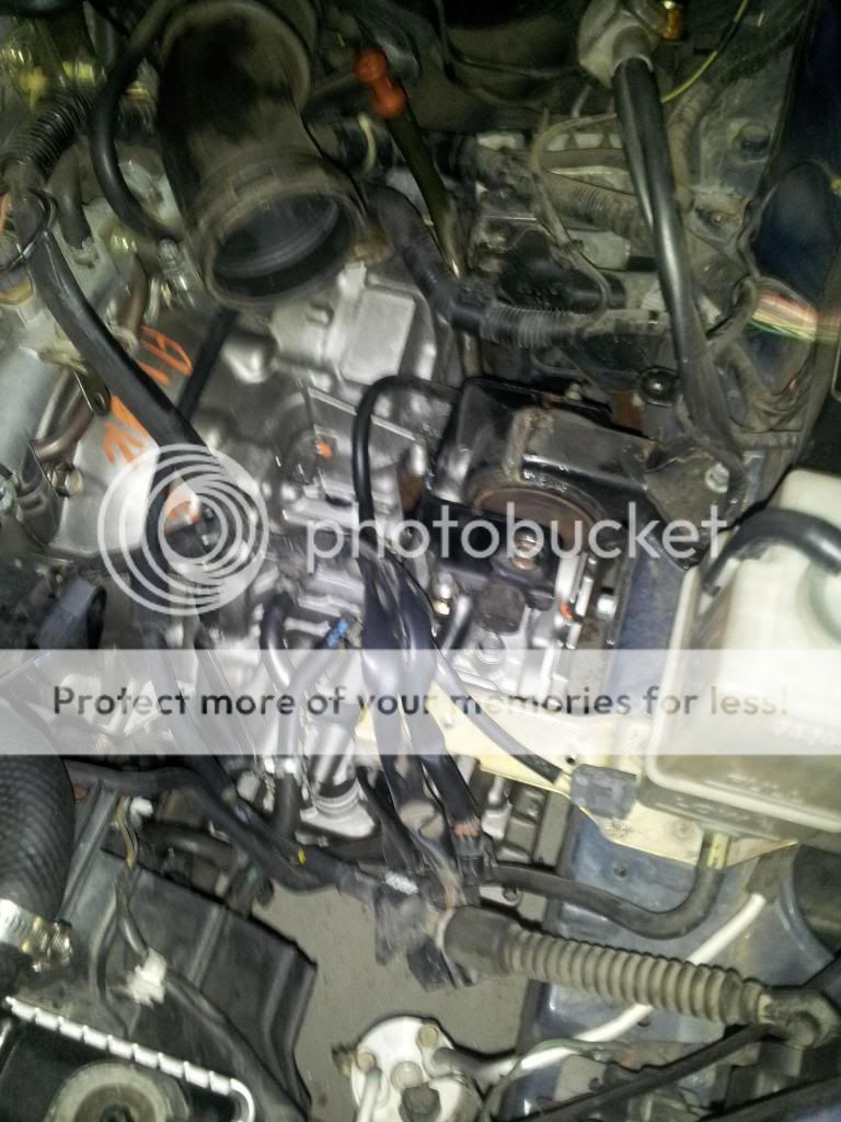

Just to put this debate to rest, I swapped a normal auto from a 2001 Protege sedan into my car, which had a sportshift, and everything works as should. Paid $600 with a year warranty on a recently rebuilt donor, remanufactured tag is on the case from the previous vehicle. Bought from Riteway in Phoenix.
Also opened the case to see where metal and noise came from, bearing on one of the output sides came apart, carrier was shredded, transmission guy at my old shop suggested replacing the whole transmission, as all those pieces are now floating around inside the trans case and will eventually cause other failures, possibly destroy teeth on the planetaries and such, which makes sense. He's replaced many of these in Fords, said the third member is the weakest link in them.
Should probably pin this info, as I searched and searched and found just as many people that said it wouldn't work. Here's your proof it does. No need to swap a manual, just find a working auto from any 99-03 protege. The part number for the sport shift model is only different because it superseded the other models, this was directly from Mazda themselves.
Update* Put 50 miles on the new transmission yesterday, absolutely can't believe how much better it drives than the old one, being rebuilt, it shifts firmer and downshift is quicker and with less throttle hammering than the last one, I never realised the old one was worn out, until I drove on a rebuilt one, it's insane.
