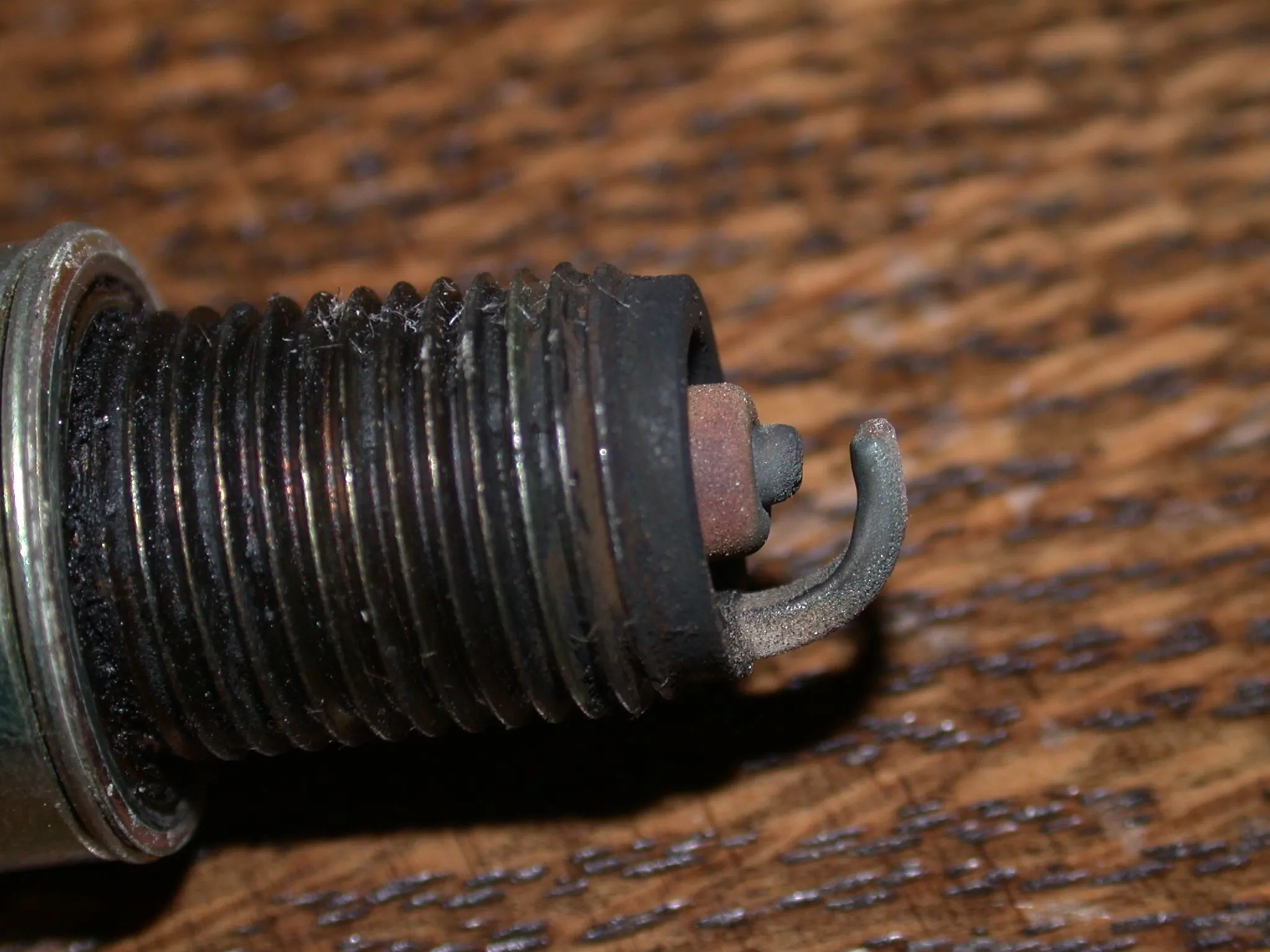

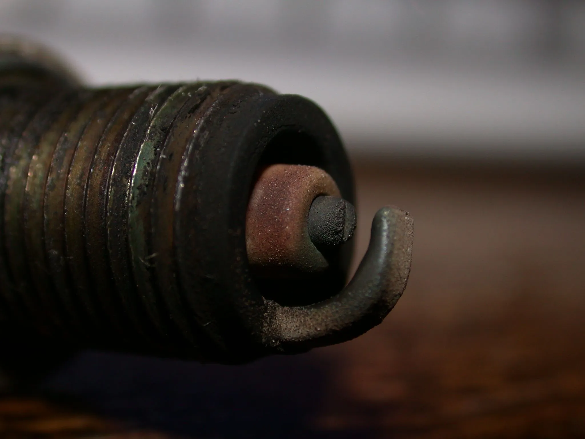

I just got done changing the plugs. They looked like s***, see pics. Schoepp changed the oil and the air filter. Tire pressure is good. I'm sure the alignment is on. Are the brakes that much of an issue with this car? I have noticed that when I let off of the gas, it slows down quicker than what I'm used to in an auto. I think this is how it is geared?

protofish, I doubt they were changed at 30k like they should have been. As for the brakes, check your rear calipers, they have been known to bind/lock up on certain runs of the P5, causing premature pad wear/constant contact. I'd keep an eye on oil consumption after taking a 2nd look at the plugs. You might want to consult one of those sites that has pictures of plugs and signs of problems to verify.

yeah, our plugs get messed up pretty quick with our rich a/f ratio. yours look like they have been there for a while. sure everything you did to your car should increase the milage......
get yourself a lightweight flywheel installed to fix your car slowing down when off gas.......
