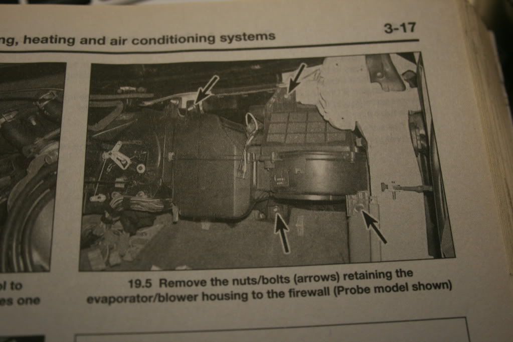

I haven't actually had mine apart on my 626, so I can't say. I'm not sure if they're the same between gens, also. I just checked my Haynes manual and didn't see anything about it in the HVAC section.
Actually, on second thought, it looks like this might be the grid. It looks like the filter is inside that. Yours could have disintegrated over the years.
That is the grid I was talking about. It is open completely with no filter like the pic shows. I have never changed it since the car was new. OOPS! I didn't know that the2002 had one. But that must be it!
