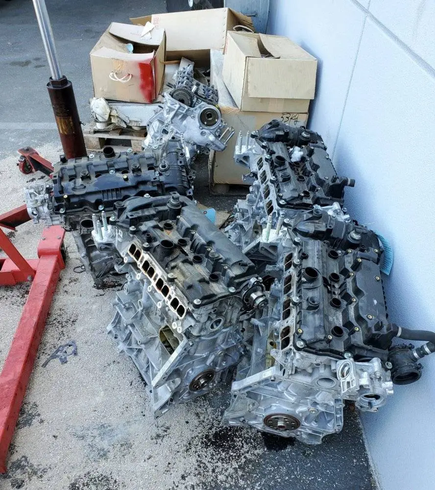

My local dealership back lot.
Tags on them indicate 42k to 62k miles
Look on the bright side. There are only about 550 dealers in the US. If each one has a pile of 5 bad engines in the back, that's 2750 blown engines. That's a failure rate of only 2%...
But how many engines were in that pile yesterday, and how many will be there tomorrow?
Yes, I was being somewhat sarcastic in my previous post. Mazda has sold maybe 200k of these engines in the US, and only a fraction of those have accumulated mileage above the 40k+ mile level. To see a stack of failed engines isn't a good sign. I'd expect this to keep happening, the only question is if the root cause is a design or manufacturing flaw that is latent in all these engines or just some of them.
...they went through extended warranty first which was denied ...
I've read VERY few good reports about extended automobile warranties, and lots of accounts of coverage denials based on a variety of 'reasons'. Can you share the details of whatever excuse they used in your case?
Yes, I was being somewhat sarcastic in my previous post. ...
I actually did think that was most likely the case, and my post was intended to head off one of the fanboys carrying forward the 'fact' of a wonderfully low 2% engine failure rate. It's always amazing to me how easily stuff like that can happen.
