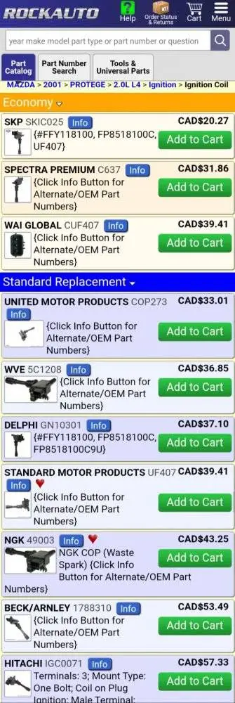

Here's a good thread about coils...
Thread 'Sudden P0421 within the past couple of days; today P0302, rough idle and flashing CEL' Sudden P0421 within the past couple of days; today P0302, rough idle and flashing CEL
Coils for our car are a real PITA.
(I've got a P5, but it's the same 2 liter engine. )
If you get new ones get good ones.
Cheap ones have been know to be bad right out of the box.
Hitachi are quality coils.
