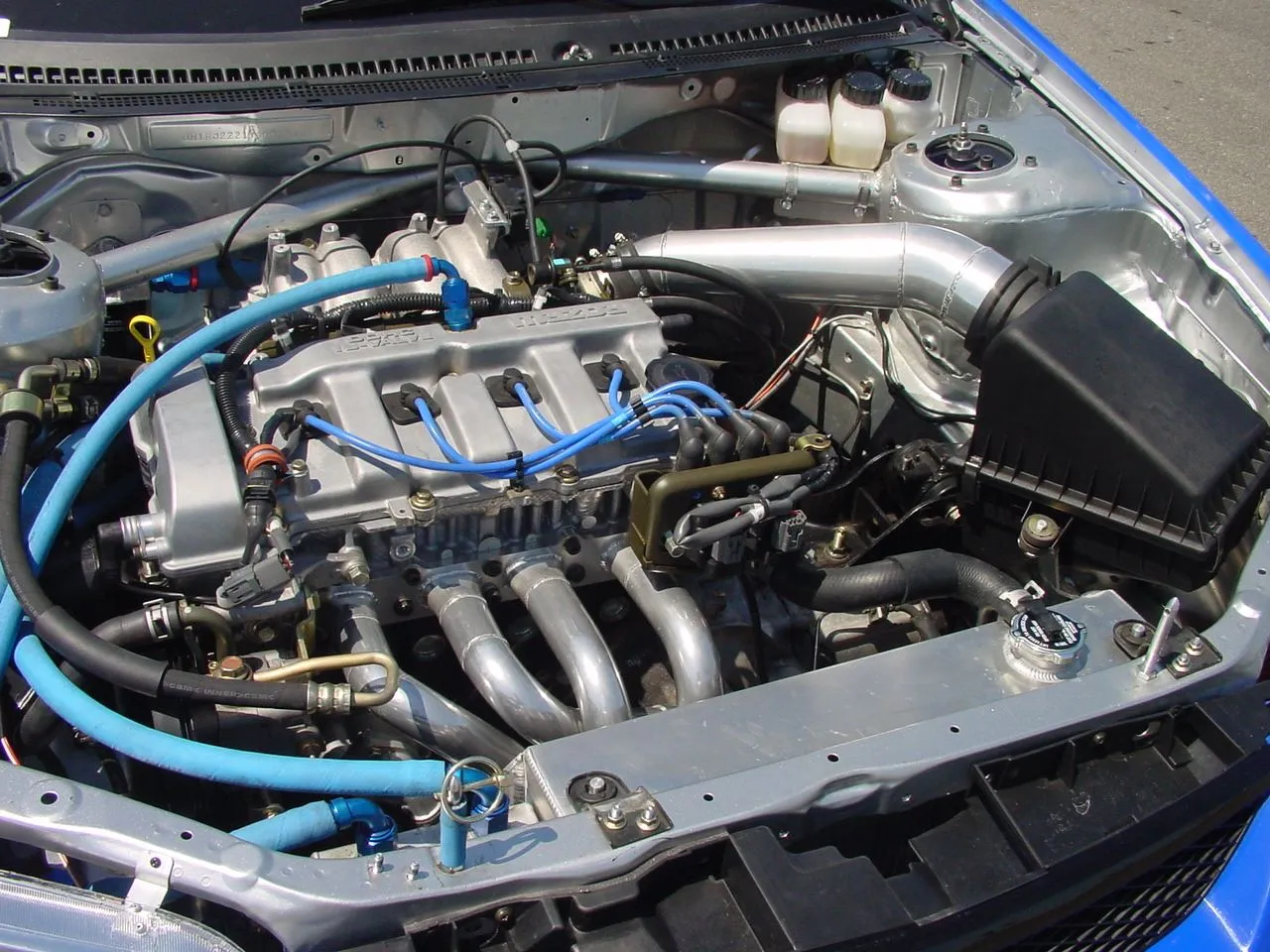

and, i was going through some old pictures, and i found the attached. if the 1.8 set-up wasnt as good or reliable as the 2.0 set-up, then i dont think tri-point would have used the 2.0 set-up on thier racing engines. but, they used the 1.8 set-up. i feel the 1.8 set-up is much more reliable than the 2.0 version.
