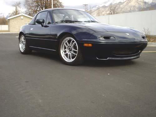

Here is the pic of my car with everything on:

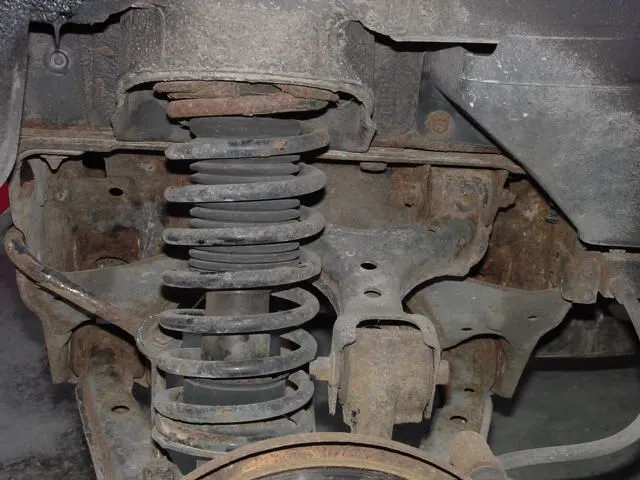

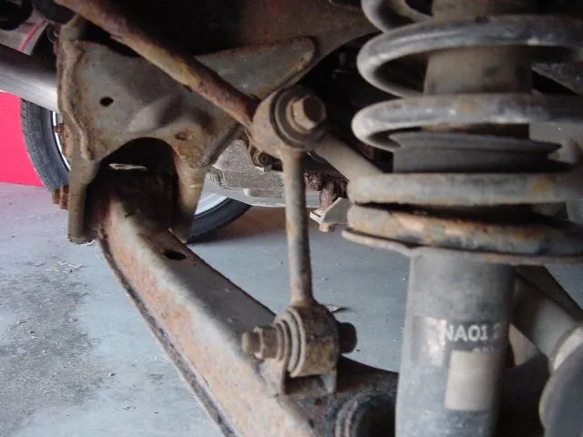

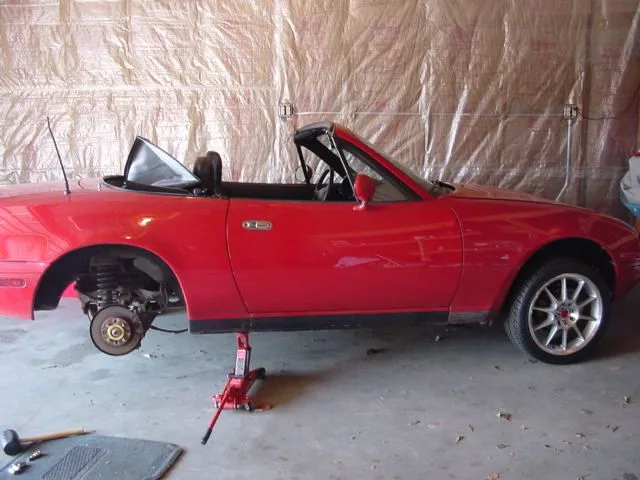

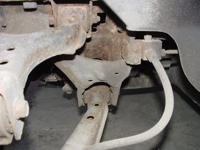

Actually i did climb under there and have a look. The suspension looks good for the most part. But i still think im going to ry to replace as much as posible because im going to have it all apart. All the bushings look quite worn.
