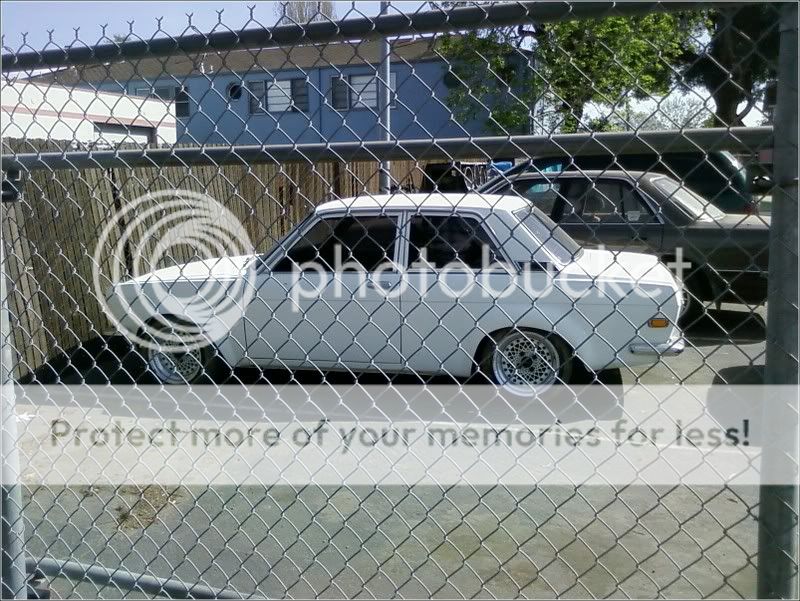

Here is my near future 510
So here is a picture of the 510 I will hopefuly be buying from my old boss in a few weeks. It has an L20 with Solex Sidedrafts. I am not sure what has been done wit hte suspension, but you can tell from the pictures that it needs the rear cross member slotted. I am not sure how involved that is. If it doesnt already have them, I will put power brakes in, prolly with bigger vented front discs and a rear disc conversion. Anyone have experience with that?

As for the suspension well it all depends on what you want to do. There are quite a few options out there. 200sx (80's models) and 280zx struts swap over once you cut off the springs and weld on coil overs like I did. Which in turn will let you run their brakes. Rear brakes you will need ot get caliper brackets but you can find some at http://www.datsuns.com/as for the rear crossmember, slotting it isn't really hard, but not really all that reccomended. What I did does take a lot of work, but if you go to http://dimequarterly.tierranet.com/ and sign up for the news letter and get some of the older issues you will be good to go. make sure to check out www.the510realm.com
it already has 280 struts up front, but the rear is stock except for cut springs and gas shocks. No details on the motor yet, but after reading this
http://www.the510realm.com/index.ph...torder=asc&highlight=jdm+tail+lights&start=60
I think I want to actually do an SR swap. Dont know where to get one or he ECU, but I have a connection to a guy in north carolina who buys rebuildable motors from japan and sells them here.
sweet. Thats cool it already has 280 struts. If you check out the dime quarterly they have instructions how to make rear brackets for 82-83 280 brakes. Or check out datsuns.com they have brackets you can order for 200sx or maxima rear brakes.
I was originally going with the SR, but they I jumped ship and staying loyal to the KA :). If you do go SR make sure you get everything, motor/tranny/harness/ecu/ignitor/maf. The last parts can be expensive. Luckly they have found ways to make z32 maf and ignitors work, but they are not that much cheaper.
