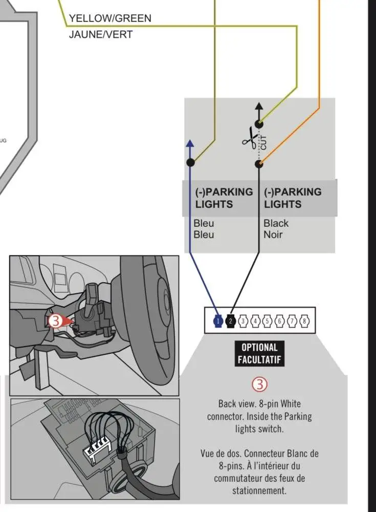

I installed the Evo One in my 2016 CX-9 a while back, I didn’t connect the parking lights simply because I didn’t understand the instruction, has anyone connected the parking lights with the t harness?

you just pull the light switch lever module straight out of its socket. the wires are in a little plastic box on the back of it. when you pull the thing out, make sure your steering wheel is straight, same when you put it back in so the clicker properly disengages in the future when you make your turns
You don't need to connect those wires. The car will flash the lights when remote starting anyway. They dont serve any other purpose other than to know when the car times out and shuts down.
I wired them into my 2019 cx-5 just because I could. In hindsight, no reason at to do it. It’s actually only used as a diagnostics purpose for which the lights can flash a certain number of times to generate a code for you to troubleshoot.
I did not wire them into my wife’s 2018 cx-9 and there is no difference at all.
