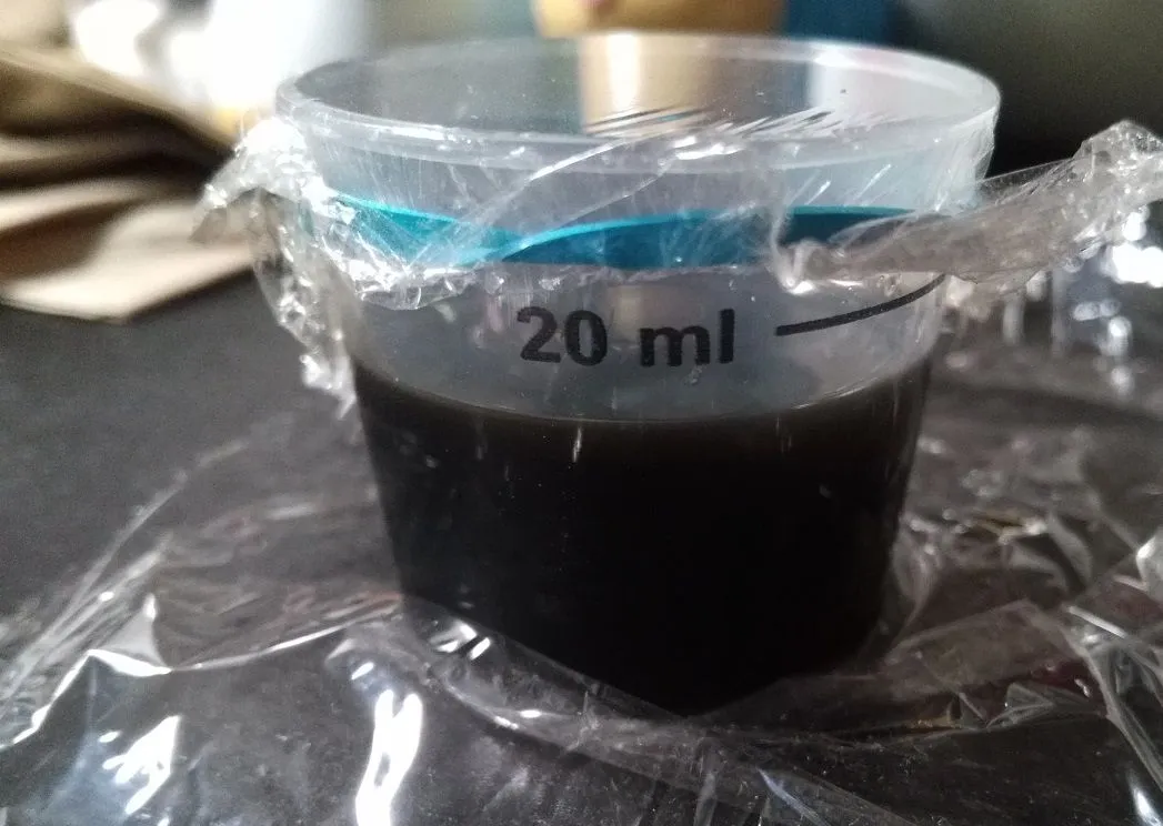

Not sure if anyone else installed a catch oil but I recently also got the mishimoto so I want to share my thoughts. Direct injection is notorious for carbon build up and especially amplified by the turbo so getting clean air through the intake is important. Installation was fairly easy. Looking for a good mounting point was the hard part. I have put 2k miles so far and this is what I drained out. It's a 20ml Robitussin cup for reference. It smelled much like fuel with fairly low viscosity. I was imagining it would be more but I guess the stock separator was doing a good enough job. However, my cx-9 hardly see RPM higher than 4k
