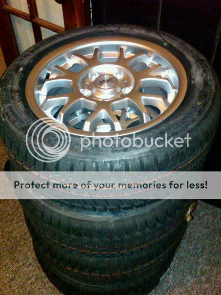

I just bought a set of 15" wheels, some cheepo sport edition ones off Tire Rack and a set of 195 55 15's off tire rack.
Could have also tried the 195 60 15's if i wanted cheaper, but i like my abs and speedo working.
