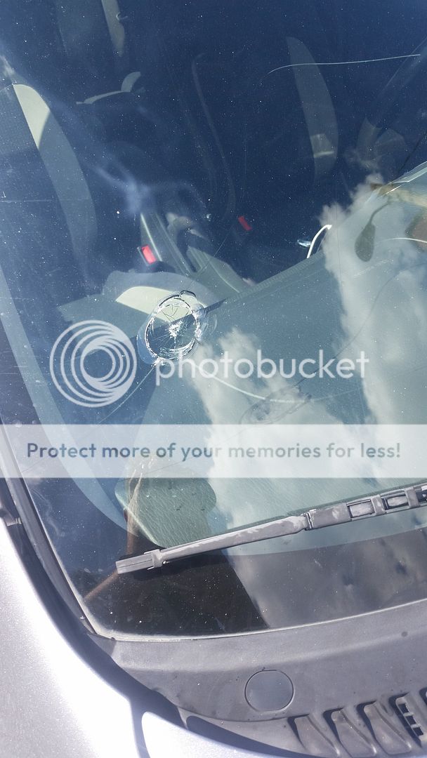

It was an expensive drive to work today. Dump truck threw a golf ball sized hunk of gravel at me
Safelite is coming to my work Wed to replace it. $215 I could have spent on the Mishimoto radiator. Needless to say, I am less than thrilled.
