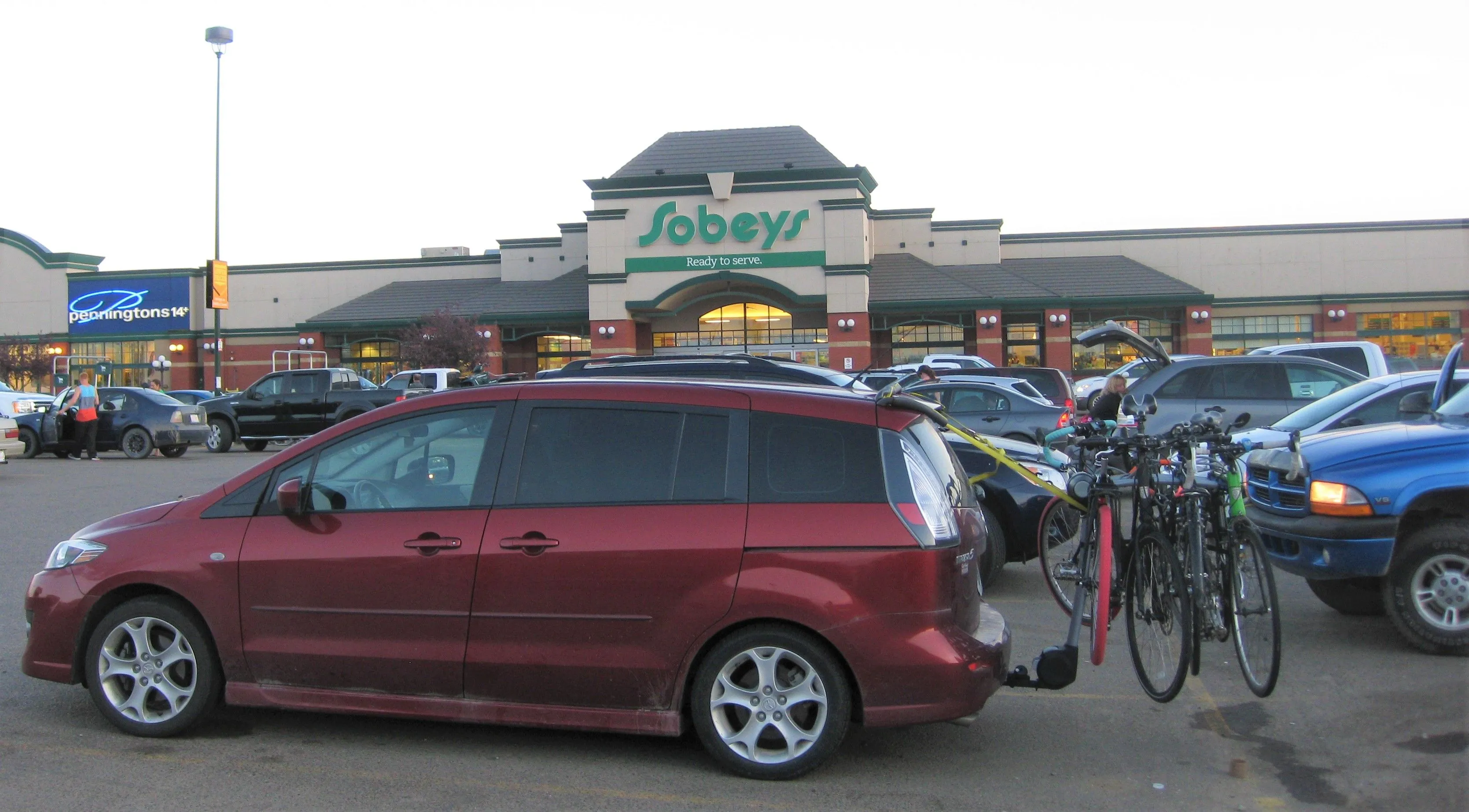

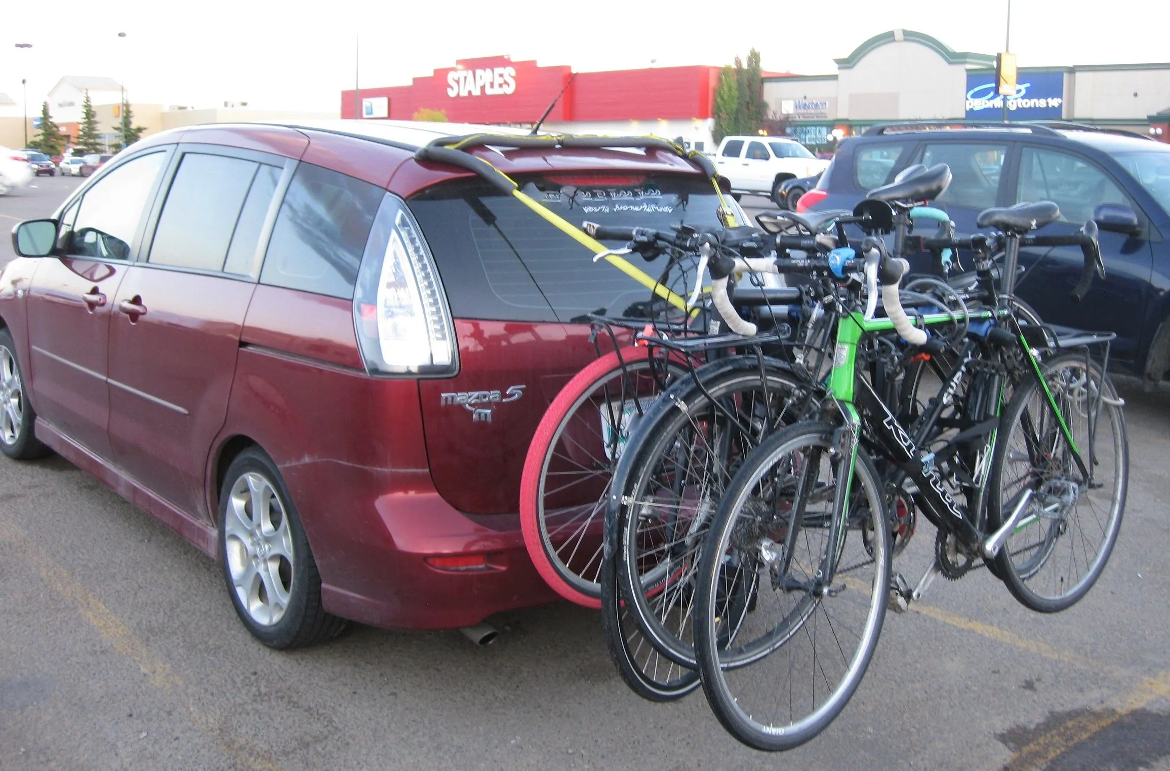

We bought our '09 Mazda 5 in 2013, and I bought and installed a Class 1 tow bar within a couple of weeks, with the intention of using it only to haul our bikes around. I don't remember the hitch manufacturer (and the car's not home as I write) but think it was a Reese. In any case, it has the square 1-1/4" receiver. Installation was quite easy. I dropped the exhaust system at the back only, and had good access. No drilling was required. The fit was perfect.
We did a family bike trip that summer, and had to carry four bikes. Our bike rack is a Thule, with 4-bike capacity. However, Thule warns that the rack is not to be used to carry more than three bikes when used with a Class 1 receiver. This confirms to me that it's either the the vehicle or the tow bar, not the bike rack, that's the limiting factor. Given that the Mazda 5 is not rated to tow, I figured the limitation was the vehicle. (Per the 'net, a Class 1 hitch is rated for up to 2000# towing and up to 200# tongue weight.) I can see how the bike rack itself (40# or so?) plus four clunky department store bikes, could exceed the rated tongue weight. I'm sure there's a safely margin built in, but why play with fire? There were lots of horror stories online of people breaking hitches off with heavy package shelves and other plug-in accessories. And as another poster said, the multiplying force due to leverage, with the 4th bike being way behind the vehicle, is significant. (Archimedes and all that.)
My solution was to reduce the effective tongue weight by running a tie-down strap through a couple of bolted-on loops, and tightening the strap to take the slack out of the bike rack and the weight off the hitch. I got the straps at a bike shop. They don't seem to carry them any more, but one could have them made. (The tail has a hole and heavy grommet. I removed the bolt where the hatch strut attaches on each side, and bolted the loop on there. Make sense?
However, there's an easier way; there are purpose-designed straps for this application. There's a big loop at one end, and a bent metal fastener on the other that hooks onto the top lip of the hatch or the trunk lid (depending on what style of vehicle you have). I'm pretty sure this is it (1 picture > 10^3 words ...):
https://www.curtmfg.com/part/18050
I don't have any photos of the Curt strap in use, but photos of the tie-down method are attached. The pipe insulation was to protect the paint on the car.
We've used the bike carrier many times since, but typically only for two bikes at a time. Regardless, it's pretty fast to throw the Curt strap on, and provides me peace of mind.
