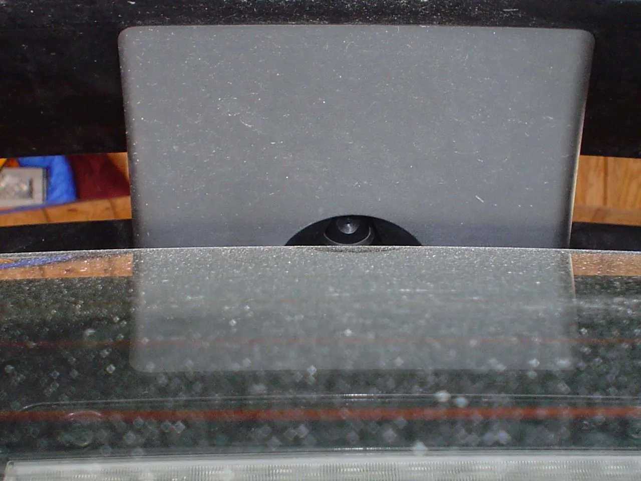

My impression is that the nozzle is directed directly into the wall of the little well in the spoiler. I took a couple pics but I'm not sophisticated enough about photo lighting so the pic from inside the glass didn't work. You can get an idea though by the outside photo I took. If you look at your own you'll see the obstructed perspective of the nozzle.
Someone ought to have a second person spray while you look at it. My bet is it's spraying straight into the recess walls (wait I already said that). I think I might just take a short video with my cheap camera.
Solutions would be to either a) modify the spoiler well or b) re-orient/reposition the spray nozzle so spray exits the well.

Well, the mpg file was too big but it clearly showed the spray blasting right into the glass, not into the plastic. This explains the fine mist and drizzle seen.

Now, for a fix? Different nozzle or orientation?
