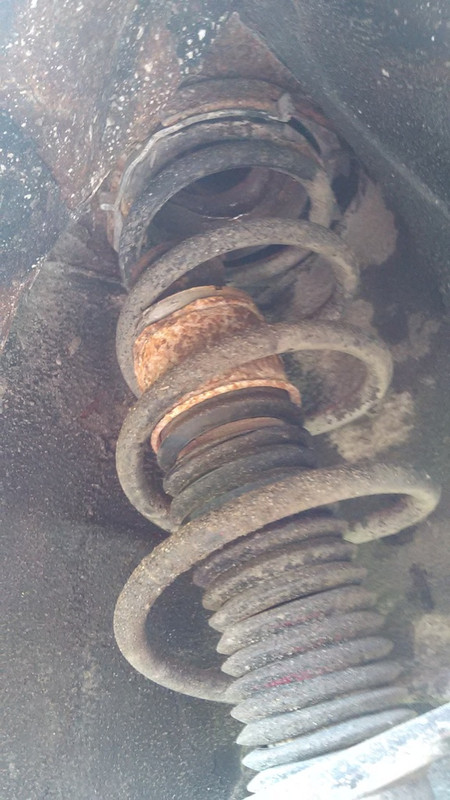

Ended up using the Monroe quick struts. Some notes on the install for the next person...
Good video here...
1) One of the top bolts sticks out further than the others, so you will need a 14 mm deep socket to remove that one.
2) My quick struts came with new nuts for the top bolts. But these are 15 mm. So I needed a 15 mm deep socket to put it on.
3) My Right side had a camber bolt in it. The nut was smaller. This was very difficult to get out. As you can see the from the pick the bolt has an 'edge' to it. This was caught and I almost ruined the bolt trying to hammer it out. Got it our by turning counter clockwise while I hit it with a hammer.
4) If your stabilizer control link is not original it may not have the allen key to hold it as indicated by the video. To remove use a 18mm open socket on the back end while turning the nut. See pic...
