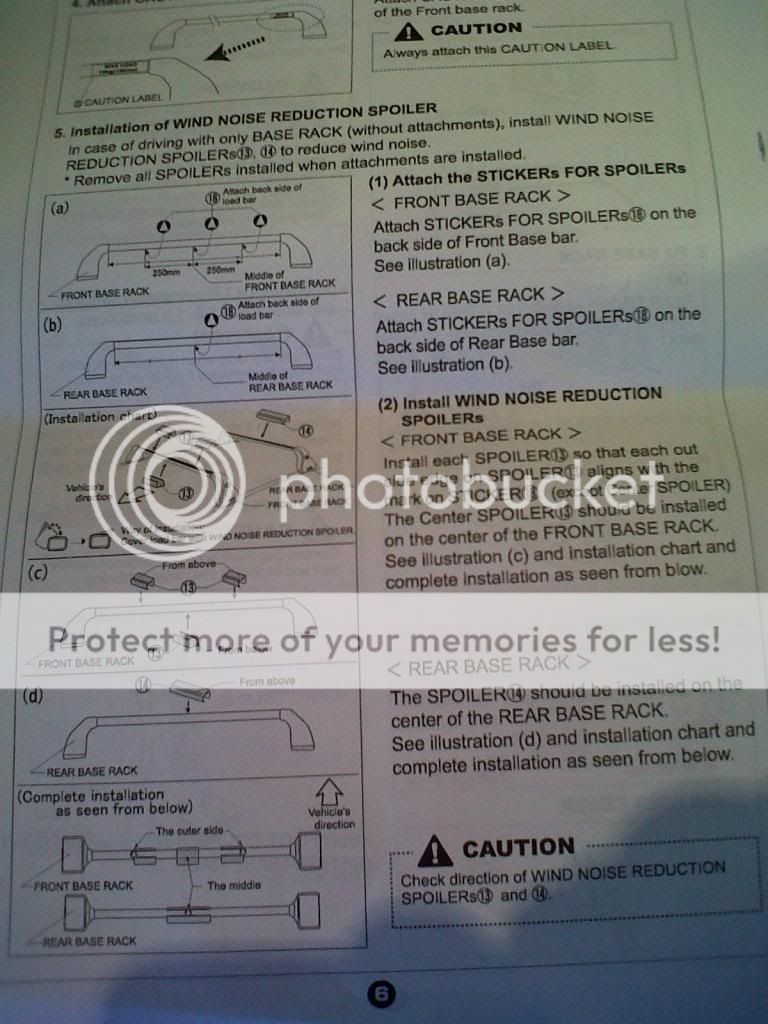

Mazda5 OEM Roof Rack Installation Guide: Gen1 (06-10) and Gen2 (12+)
Similarities
-Same weight limit
-Require wind diffusers
-Made by Thule. Gen2 is stated as such, Gen1 is a guess based on the security key! Mazda is not in the business of making accessories
-Mazda recommends do NOT operate the moon roof however it sounds like Gen1 rack can clear but Gen2 ‘may’ conflict depending on what you have on top… See WARNING section of install guide.
-Gen1 and Gen2 bars are interchangeable as the mounting points on the roof have not changed in the different Mazda5 model years.
Differences
-Gen2 bar is wider (sticks out more) so you have more carrying space and looks better than the Gen1 bar.
-Gen1 bar is easier to install/remove (hardware is built-in). Gen2 bar is a bit more cumbersome and requires tools (hex key and nut wrench) and more parts involved.
Gen1 (2006–2010)
Part# 0000-8L-L09 (new) CC43-V4-701G (old)
http://www.freefilehosting.net/mazdabaserackinstructions20062010
Gen2 (2012+)
Part# CG15-V4-701
http://www.freefilehosting.net/mazdabaserackinstructions2012up
