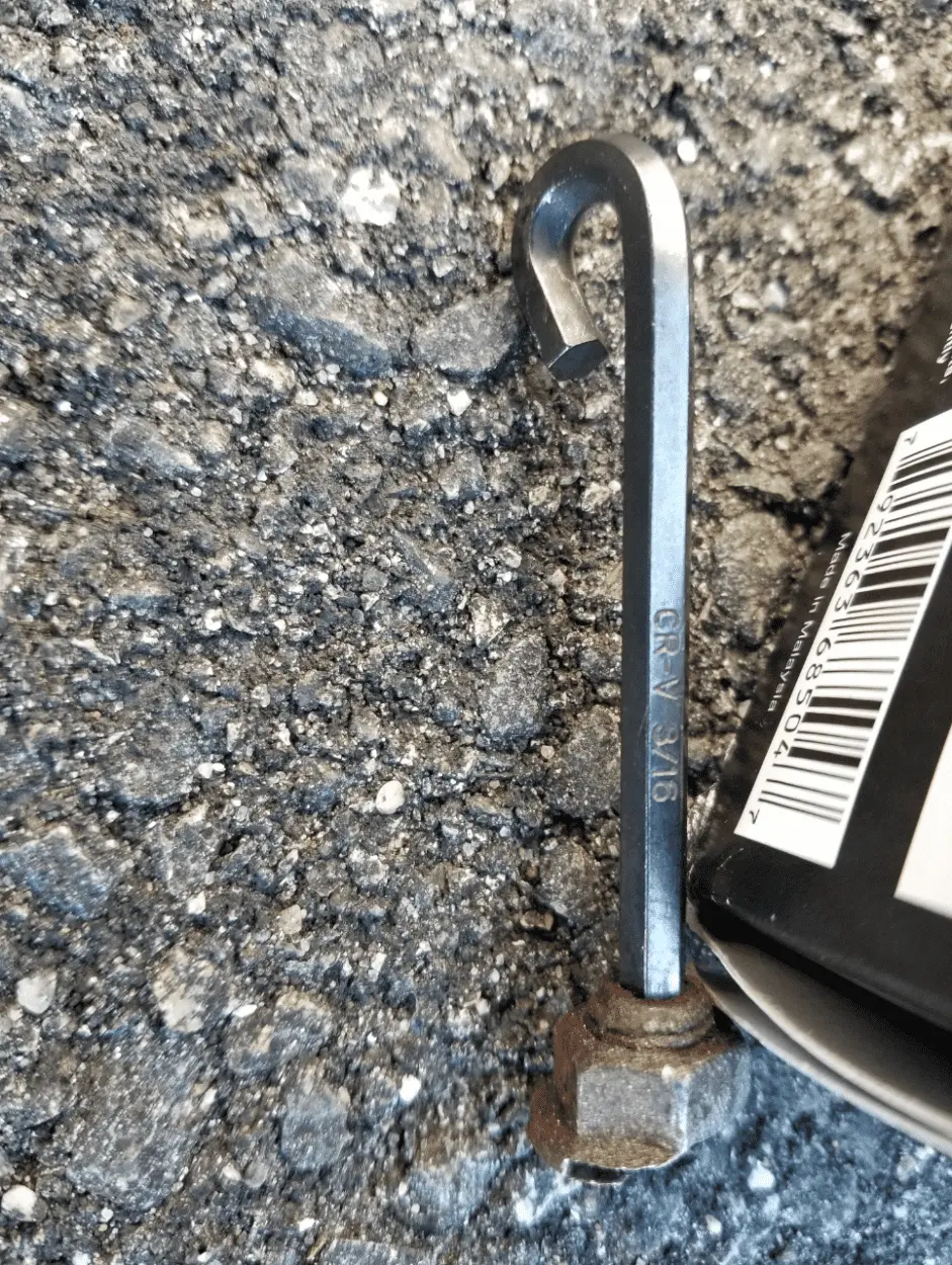

  1. (Optional) Long reach 5 mm 90 degree Allen Key: Used to hold the bolt steady when you are attempting to loosen the stabilizer link. Each end of the stabilizer link has a pre-cut hole for the Allen key but assuming that you have tons of rust on yours, there's probably no reason to bother with the Allen key.

  • You will not be able to access the top nut of the stabilizer link using the long portion of Allen key as there is not enough clearance and the only way would be using the 90 degree portion.

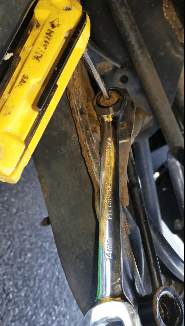

What should've worked but didn't because of the amount of rust. Ultimately, the nut started to spin freely and I knew that it was toast.
The biggest issue is this little washer on the opposite end that will keep spinning if you try to just loosen the nut.
