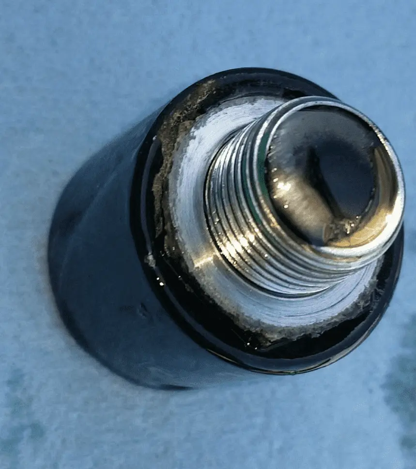

F. Pictures
Unfortunately, I did not take too many photos but here are some for reference:
Front Transfer Case
Rear Differential
