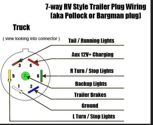

Anyone do a wire run from the back to the battery on a 2nd Gen CX9? Will be running one from a 7 way trailer plug to the battery and was just curious if anyone has any tips?

You want a 40 amp circuit breaker on the car's firewall near the battery. Your wiring goes from the battery positive post through the circuit breaker and back to the +12v terminal on the 7-pin connector on the back of the car. Use a stout wire, probably a #10. You will also want to run a negative wire, at least #12, from the 7-pin connector ground pin back directly to the battery negative post. Don't trust using a negative circuit through the trailer chassis or the car chassis for anything as critically important as your electric brakes. The center pin on the connector is often not used, although back up lights on the trailer are really handy when putting the trailer into a spot after dark.
