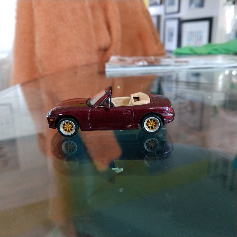

When you have time on your hands, you discover a set of wheels on a Hot Wheels diecast that match the ones on your car. You buy said car to obtain the wheels, then remove them for painting. You also remove the wheels from a Johnny Lightning diecast that is exactly your car (color combo/year), only to find the wire axle that company uses is smaller than what Mattell uses. You then buy a numbered drill index, dig around to find a pin vise bought decades ago for modeling purposes and open the slots in the JL chassis to accept the HW axles. Finished result is almost a match for mine (just missing the rear spoiler). Will give me something to look at while gone.

It's nice finding your car in a diecast. I had to wait a long time to get one of my RX-7 (we're talking decades). I was surprised that JL made one for my specific trim, I have a small store of them.
FYI the one you have states it's 1/64 scale but I am not sure about that. Before I found the HW miata with my wheels, there was one of the MiniGT NAs in silverstone with my wheels already in gold. I bought it but when I went to swap the wheels I found they were markedly smaller than the ones for the JL. HW and JL seem to be fairly close scale-wise so I'm calling them 1/64th.

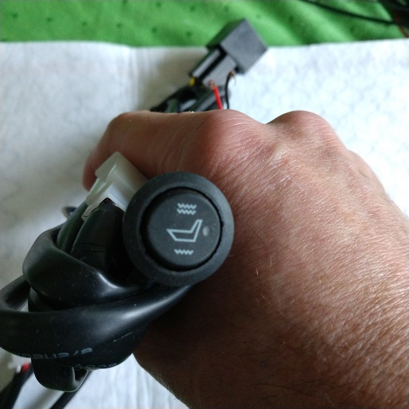

It has arrived (finally!). Let’s see what we have here. Package was basically intact (one small tear):
Open ‘er up:
Did you figure it out yet? If not here is one last picture, if you don’t get it from this one I can’t help you.
That’s right, a seat heater kit complete for two seats. I bought it from here: https://www.mx5city.com/heated-seat-kit. I see the price has dropped a few since I bought mine. I reached out to them to ask about shipping to the US before I ordered and they said they either used UK post for about $30 (said 7-10 days shipping), or $47.50 for FedEx (said that was 3-4 days). Being frugal (some might say cheap) I opted for the lesser charge. However that turned out to be an exercise in frustration. Below is the timeline for this transaction:

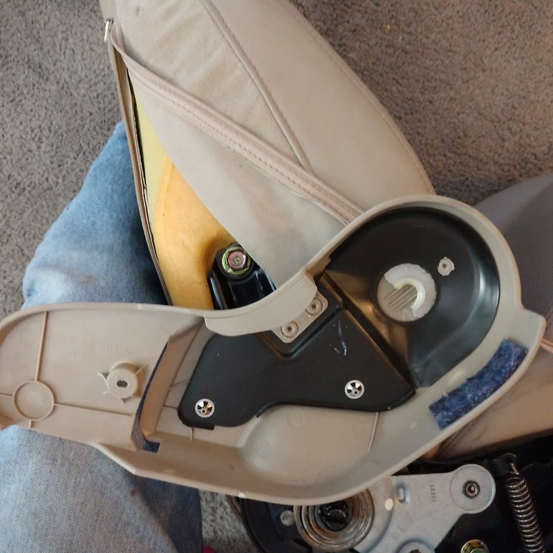

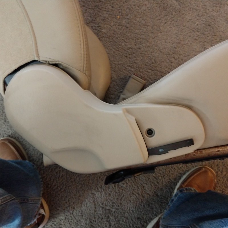

Didn’t have much going on today so decided to dive into installing the heater pads. Pulled the passenger seat and dug in. I am running NB2 seats so my disassembly relates to those. First you need to separate the back and bottom of the seat. First off you remove the recline lever by pulling it forward. It slides onto a metal lever and is only held on by a tab that provides a spring loaded function. Once that is off remove the small screw hiding behind that.
You next remove the trim piece. This is accomplished by sliding it back and upward to get it clear of the mechanism. You can see the half-moon shaped white piece that holds it on here:

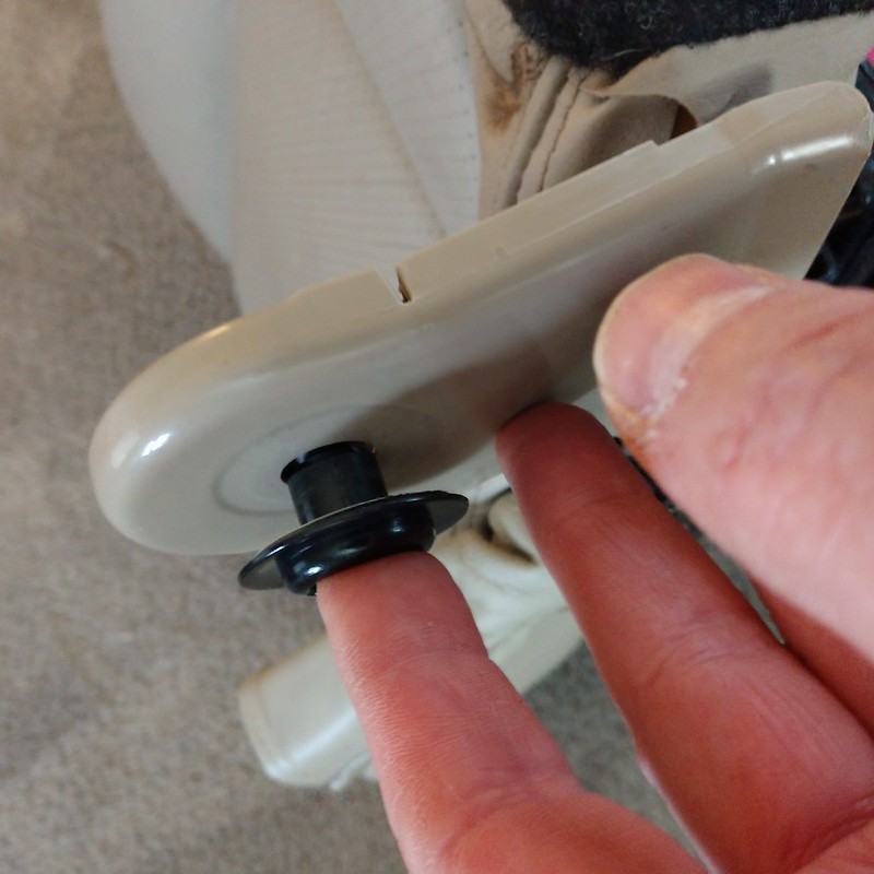

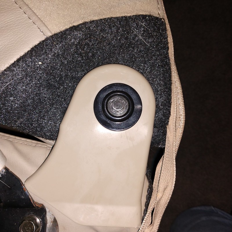

Next I removed the small inside hinge bolt, and then pulled the black insert out of the trim piece before removing the trim piece:

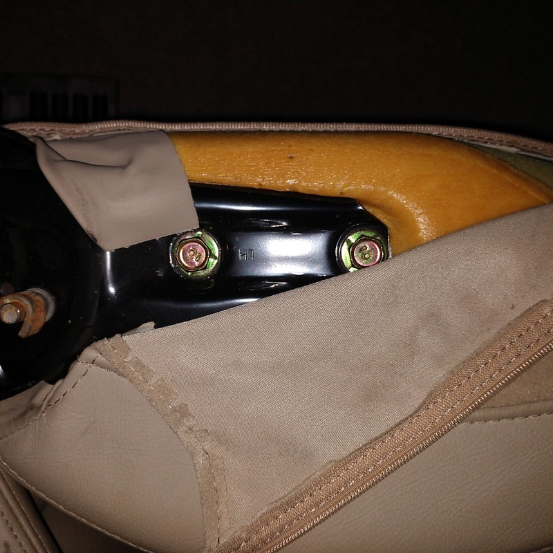

Next you undo the two zippers at the bottom of the seat back to access the outside bolts:

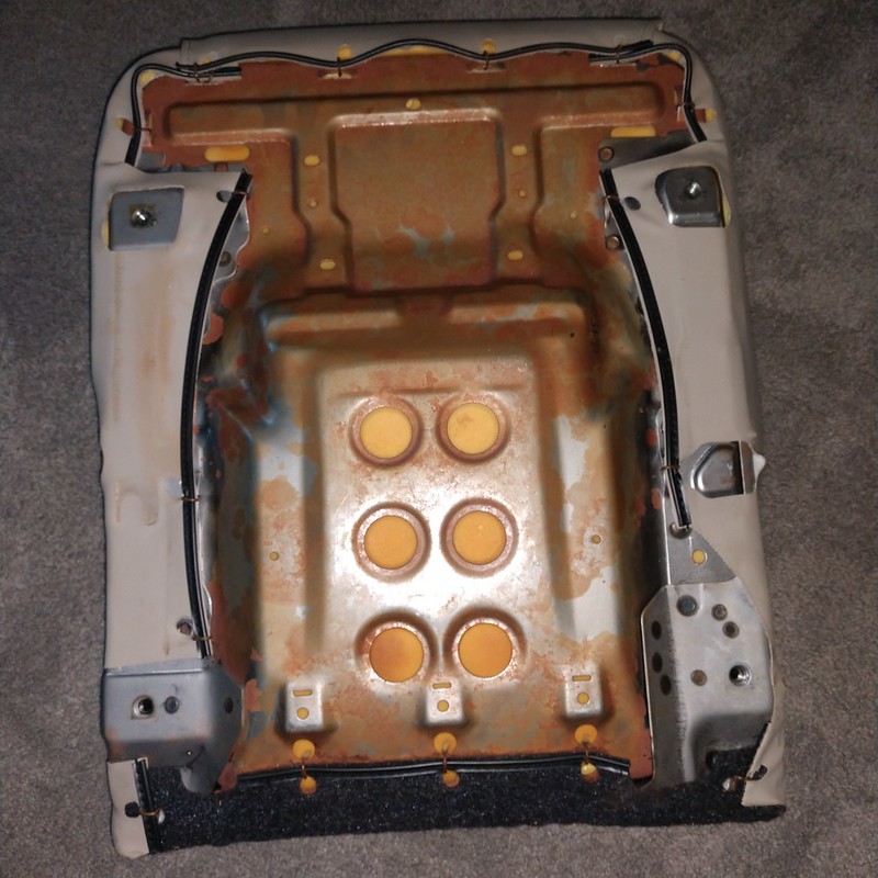

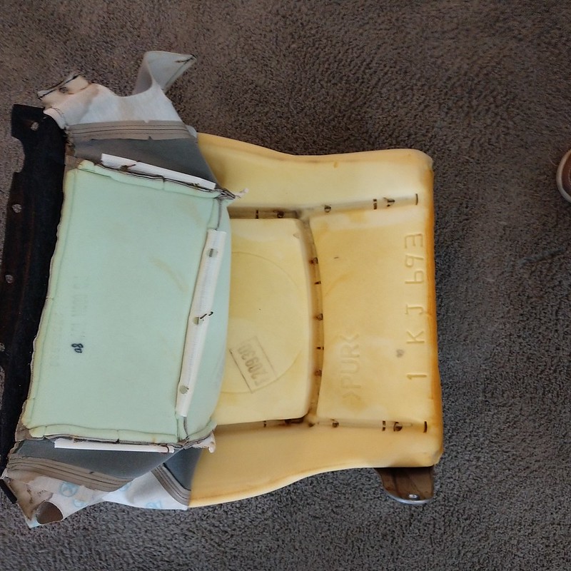

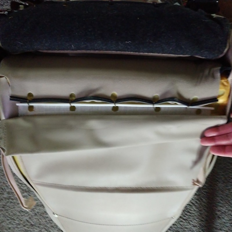

Once all that is off the seat back is free. Now you start removing the hog rings. I used two needle nosed pliers and a flat blade screwdriver to pry if I had to.
After these first five you peel the cover back and remove the hog rings as you go. I counted 16 total for what I got to. Here is the seat cover pulled back:

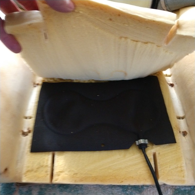

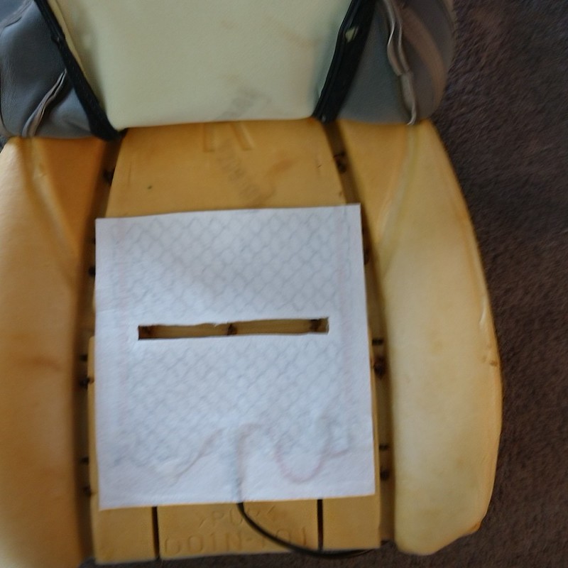

I then laid one of the heater pads on the foam to see where I need to cut it. The pads have two areas with space between the heating coils, you cut across those areas to shorten them as needed. Take care not to cut through any of the coils. For my use I removed one of the sections. The instructions say to not have the heating coils lay across any gap in the foam (used for hog rings to secure the cover). I cut out the space between the two remaining sections of the pad. Once you have that all set you remove the backing from the double-sided tape running down either side of the pad and lay it in place.
One tip to make life easier, figure out where you need to remove the fabric of the pad for cover hog ring access before you tape the pad in place and cut it then. I used an X-Acto knife for this but for the second pad I started the cuts and then did the rest with scissors before taping the pad in place.

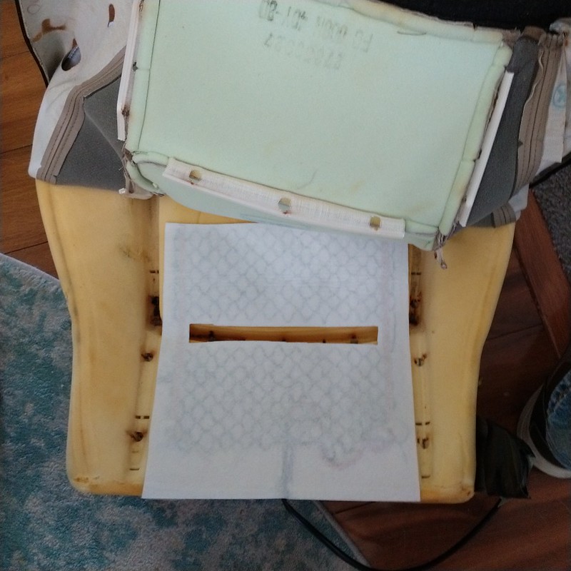

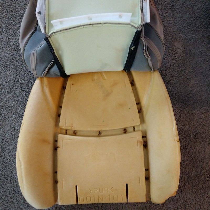

Next up is the seat bottom. You will need to remove the sliders (total of six bolts). Once that is done the bottom will look like this:
Then it’s back to removing hog rings to pull the cover back so it looks like this:
I counted 21 hog rings removed for this one. Repeat the same steps for installing the heating pad. I made the same cuts as I did for the back pad for both length and hog ring access (no picture of that as I was on a roll and wanted to get it done). Once that’s done you just reverse the disassembly steps until it’s all back together. Be sure to route the wires for both pads to the inside of the seat. It took me about 2 ½ hours to complete this work.

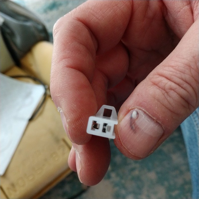

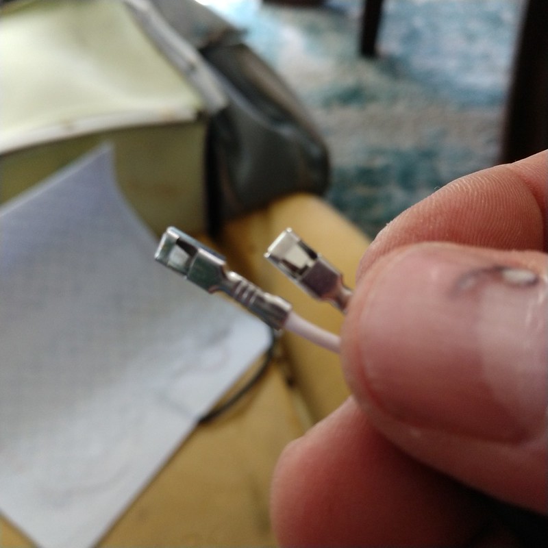

I’ll continue once I start doing all the wiring hook-ups. One thing I did note is that the wiring connectors for the heating pads were not all the same. Three had a red wire on one side of the connector, the fourth had the red wire on the opposite side of the connector. I don’t know who made the connectors up but someone wasn’t paying attention.

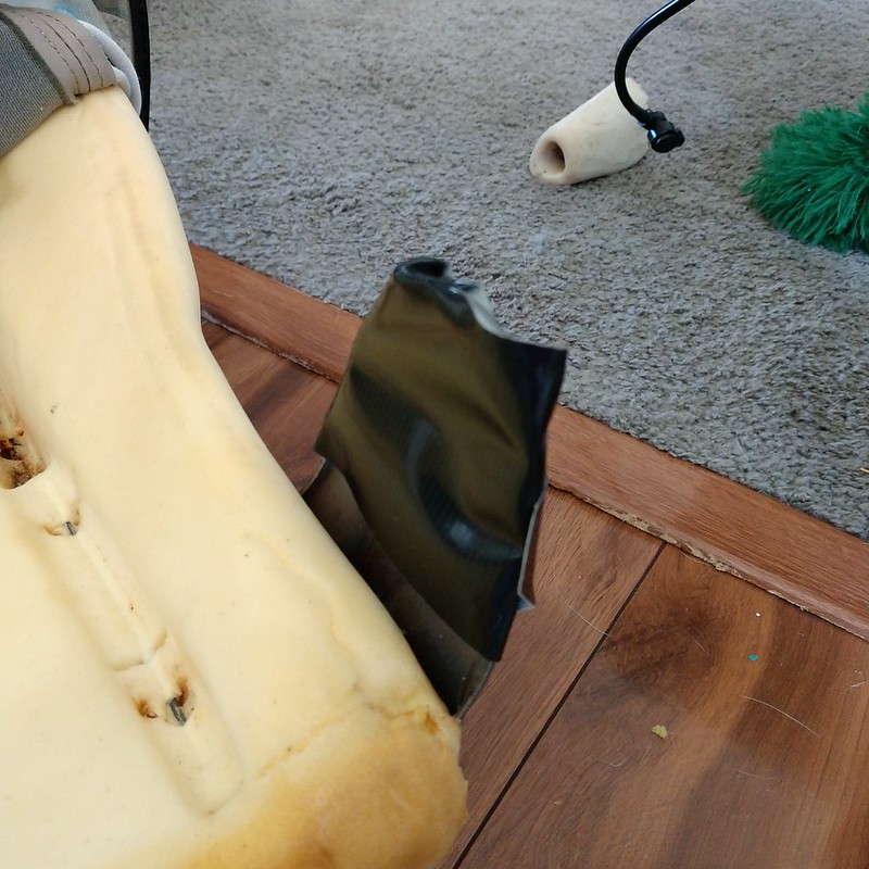

Ended up not doing what I had planned today so pulled the driver’s seat to get those heater pads installed. This one took a bit longer because I have a pneumatic lumbar support installed and I didn’t want to lose it. Followed the same procedure to separate the seat back and bottom, pulled back the back cover and took a look at what I could do. I figured it wouldn’t be a good idea to put the lumbar bladder over the heater pad. There is a foam lumbar support at the bottom of the seat, I figured I could lay the bladder behind that. I started my cut with the X-Acto knife, then used a fine (24 TPI) toothed hacksaw blade to cut up through the foam by hand. This is how that ended up:
I left the foam attached along the top side to provide some stability. The lumbar bladder I have is the one Moss sells, I bought it second-hand so saved some money. After some checking I trimmed the ends of it and then put it in place like so:
Once the seat cover was laid in place the bladder was held firmly.
As I mentioned in my last post one of the pad connectors had the wires reversed from the others. It’s fairly easy to change this. If you look at the connector you will see two smaller rectangular openings next to the main openings. If you insert a small metal piece (I used a jeweler’s screwdriver) you can depress the lock and remove the connector end. Here is the opening, and a shot of the connector on the wire showing the small tab that locks it into the plastic part of the connector:
Got that changed over. Another helpful tip I didn’t do on the first seat, the piece that acts as the anchor for the inside hinge bolt is sheet metal with sharp edges. I managed to cut myself doing the passenger seat, didn’t feel it or even notice it until I saw some blood drops on the heater pad. In the interest of avoiding this today I put some Gorilla tape over the metal like so:
Finally, since I neglected to post a picture of the pad installed in the seat bottom yesterday here it is:
You may notice that there is some overlap of the pad at the back of the seat. This just wraps under once you put the cover back on. For some reason the driver’s seat bottom only had 18 hog rings (same number for the seat back though).
