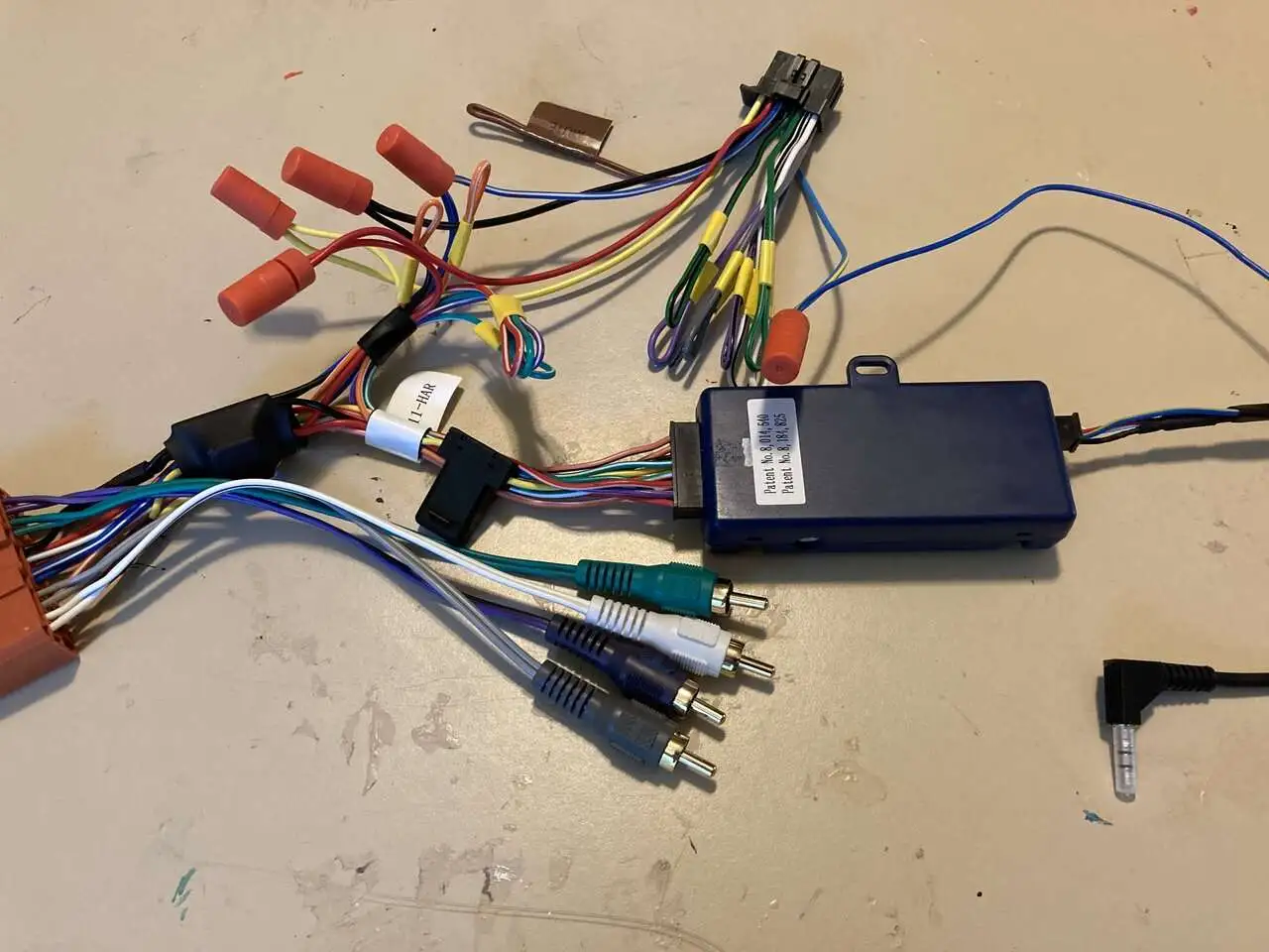

Here's a shot of all the pre-wiring done. Crutchfield's wiring guide (which they email to you with your order confirmation) was extremely helpful.

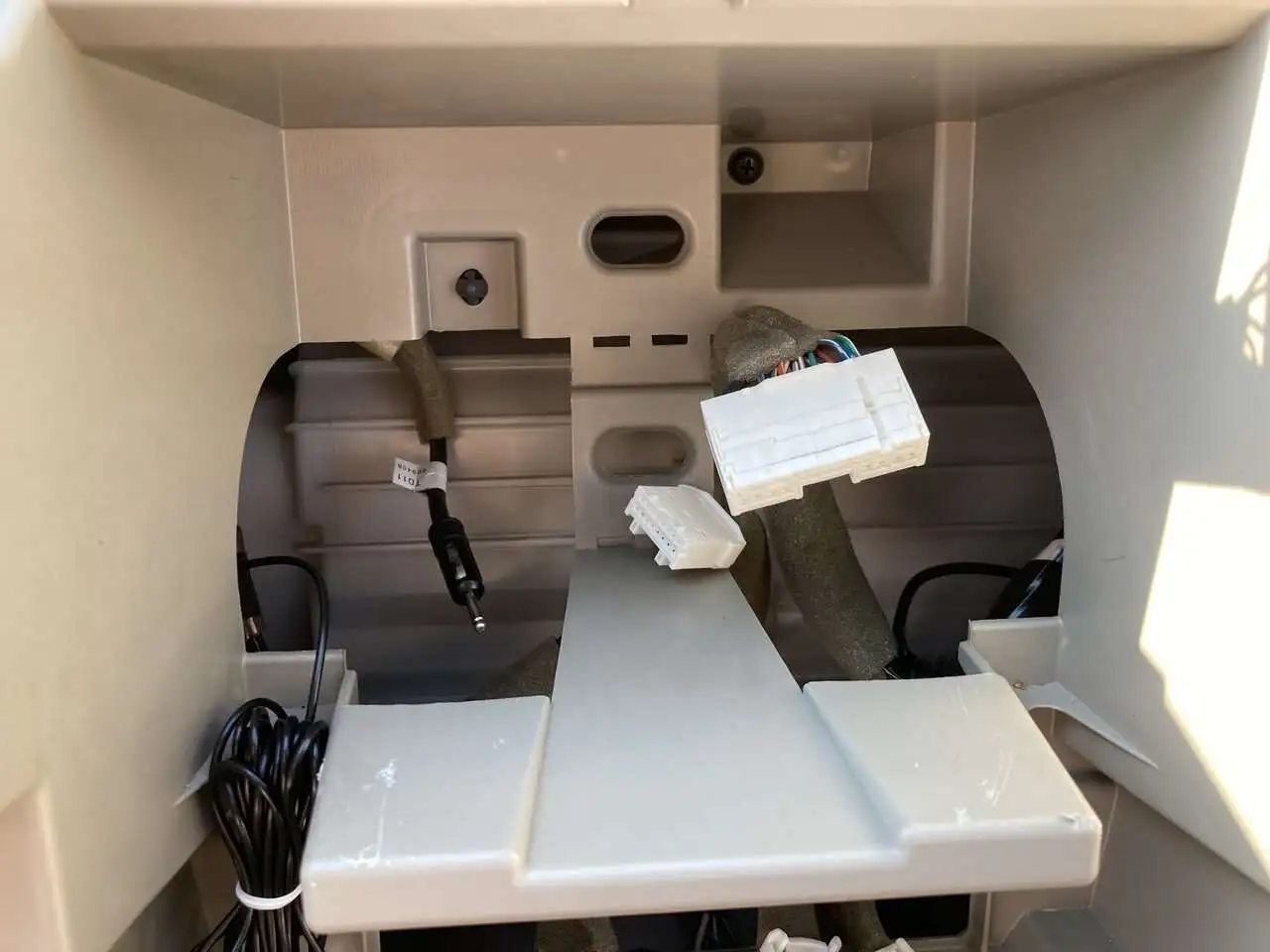

I ended up calling Crutchfield three times though. First time was to ask about the smaller wire harness I found plugged into the factory HU, as shown here. They confirmed that it is to be left unconnected (as there is nothing to connect it to).
