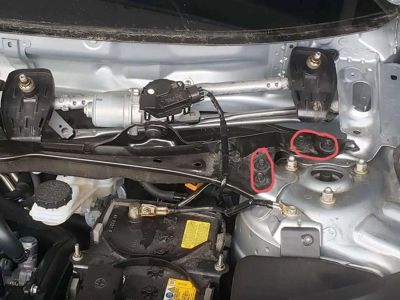

Just inside each strut tower (the towers each have 3 silver bolts/nuts) there is a brace/bracket between the two towers (black horizontal bar in picture below). Each end of this bracket has 2 black bolts/screws that hold it in place and these are what need to be tightened. 12mm IIRC.

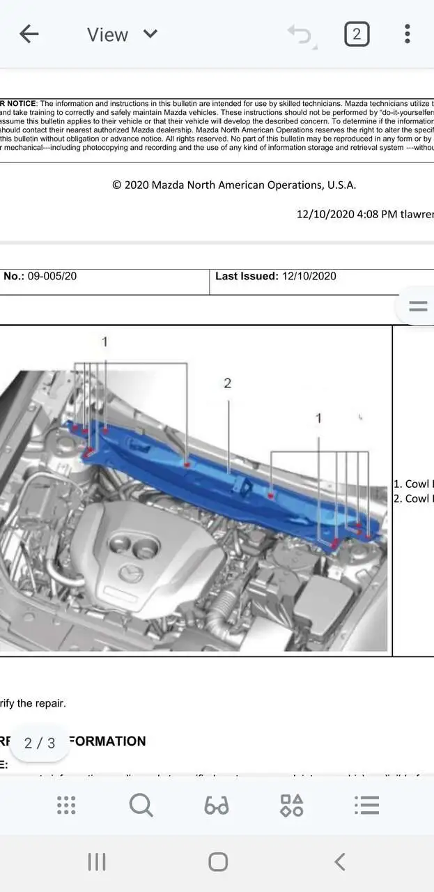

Its not just 2 cowl bolts on each side its 6 bolts, 12 total per this tsb. This is effectively a strut tower cross brace. Increases torsional rigidity. I just tightened the 2 visible bolts on each side but looks like there are more bolts under the plastic trim piece. Just thought I would pass it on.

  • MC-10202693-0001.pdf

You can get all 4 bolts (each side) without removing the big plastic shroud. The two under the plastic shroud can be accessed by popping out the plastic rivits and then you can lift up on the plastic and get on those two bolts with a box end wrench. To get the 29ft-lbs the double wrench technique comes in handy.

Thank you all so much for the pictures a guidance! My 2019 was making a clunk that sounded like suspension when going over bumps turning into and out of driveways.. not all the time but felt like it was when the suspension was compressed. So pretty much a bump and not a dip or pothole. I have been looking and inspecting the suspension as I started noticing it after a brake job, which was weird because the only bolts loosened were for the caliper. Turns out it was the 2 bolts circled in the picture you posted. I did take off the plastic rivets and checked the other 2 but they were tight. The 2 outside the shroud were not loose enough to turn with fingers, but they turned 1/4 turn if not more with a wrench.
