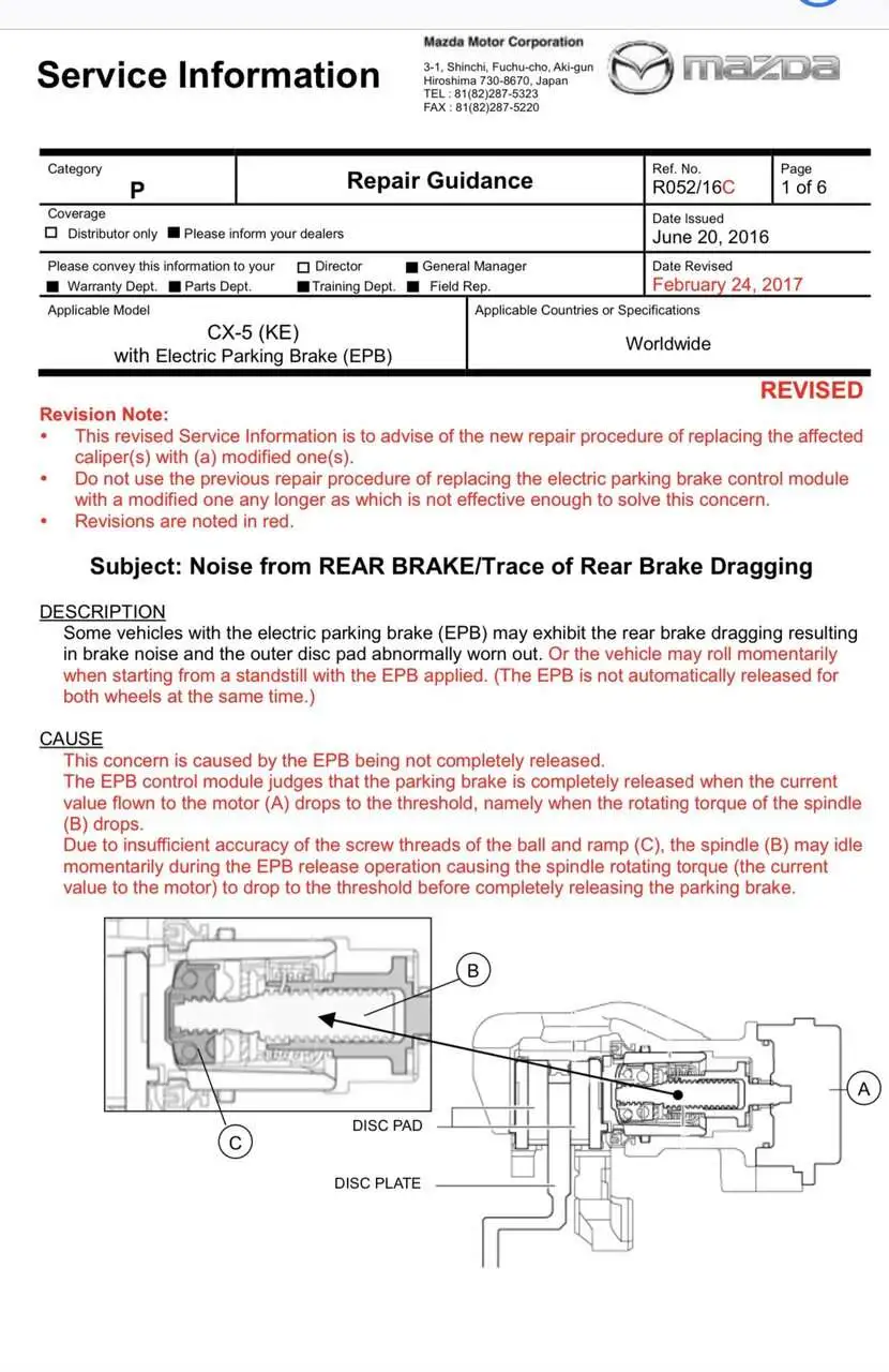

Honestly, you should consider to get a pair of updated rear disk calipers as the original ones on your 2016 CX-5 are prone to drag or lock-up the brakes with EPB.
TSB No. 04-001/18: Noise from Rear Brakes Due to Brake Dragging
