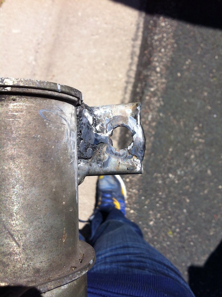

After a few weeks of installed the clunk fix bracket the passenger rear endlink tab snap now the driver side, what's going on? , I lowered the car with eibach pro kit should I need longer endlinks.
I drilled a new hole and put the endlinks there
Are my eyes deceiving me or are you really trying to force that newly drilled out-of-its-place hole to fit the remains of the original installation?
Have you for 1 second considered that this sort of hack job could easily result in a profoundly different setup geometry ?
Untitled by cmezz331, on Flickr
mine snapped because there was play in it, as it wasnt tight enought so it kept neing pushed up and down into the tab. put a couple washers in there, works fine now. stopped the clunking too.
Are y'all runing the tokicos? The previous owner of my car put Monroe's on it. Tokicos are made to handle the bigger sway bars.
