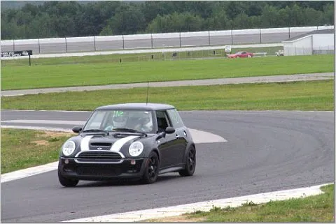

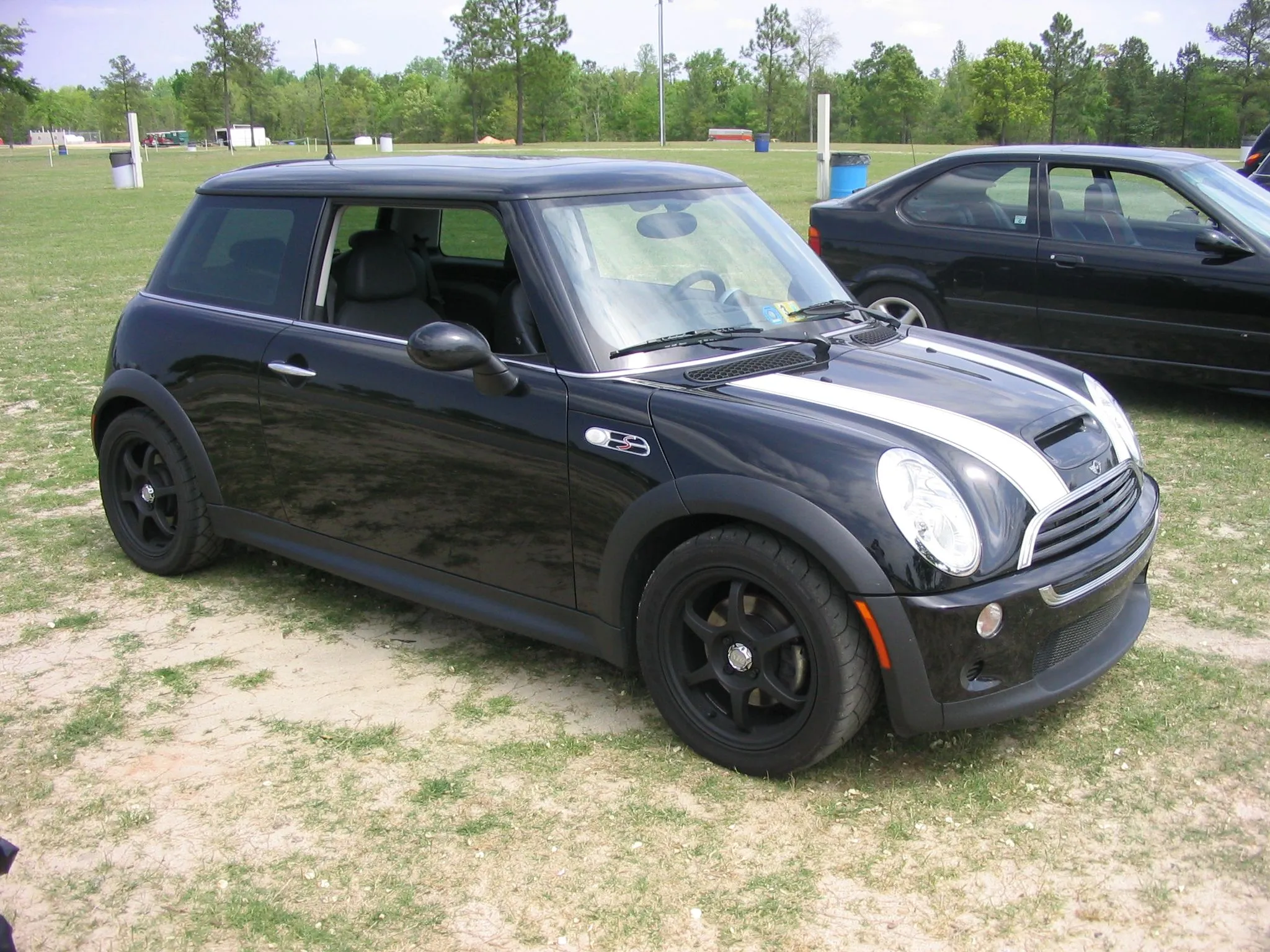

I haven't had a front wheel drive car since my Cooper S which came with 17" wheels. I bought light weight 16" and some wide Azenis tires and the handling, steering and overall road feel was greatly improved (obviously some of that was due to dumping the runflats). That thing was a monster at the track too.

Your Mini isn't a fair comparison per se, it's a track monster regardless of what size tires & wheels you slap on it.
