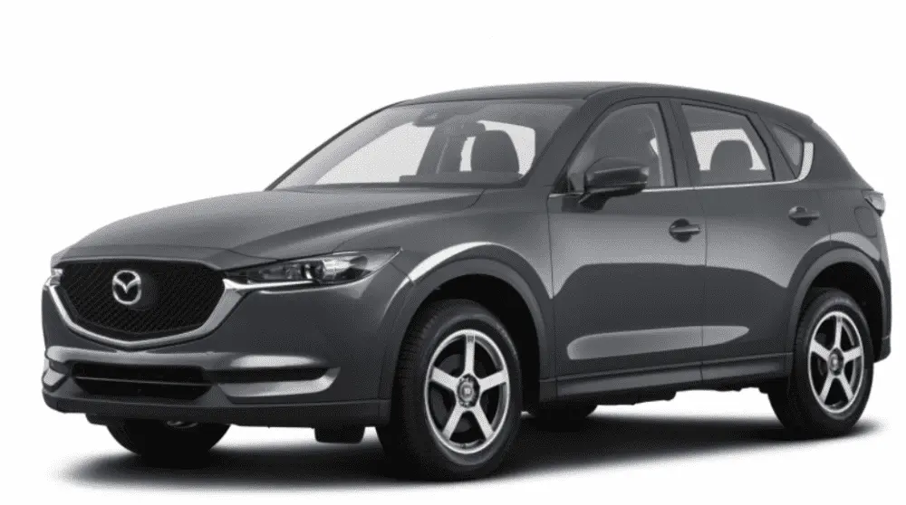

18 Mazda CX5 AW

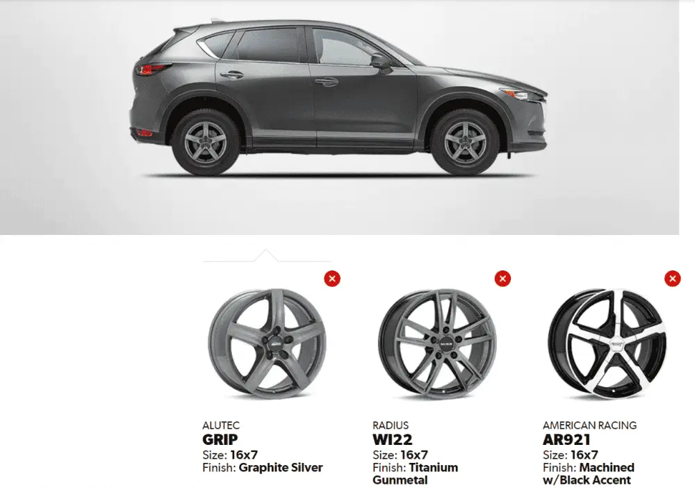

Looking to downsize to a 16" rim on CX5 non-turbo so could get extra sidewall
and maybe lose some more un-sprung weight.
Was going to downsize to old Mazda tribute 5-spoke wheels similar in offset, centerbore, etc. to the cx5. Cheap and can be found under $100 each but the weight is still a heavy 25 lbs. Should hold up for off-road or any highway bumps/potholes, etc. They are equal in weight to my 17" BBS wheels.
Am having trouble locating all manufacturer info to compare wheels,
especially whether gravity cast, low-pressure cast, or tilt cast form flow. Some just say "cast" without specifying which type.
It also appears that there are very few if any comments or reviews on the web.
However, have narrowed down six choices that appear to go well with the Machine Gray. Have attached screenshots below. Any suggestions for which one to choose?
Volks are too $$$ and none of the Enkei's( incl the RFP1's) went well with the machine gray.
Does anyone have any bad experiences and or any preferences with any of the manufacturers below ?

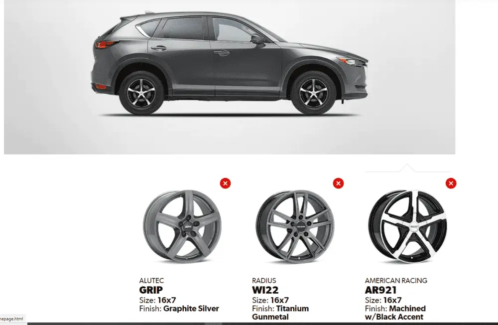

Alutec(Rial)
Konig
American Racing
Radius
Liquid Metal
Montegi

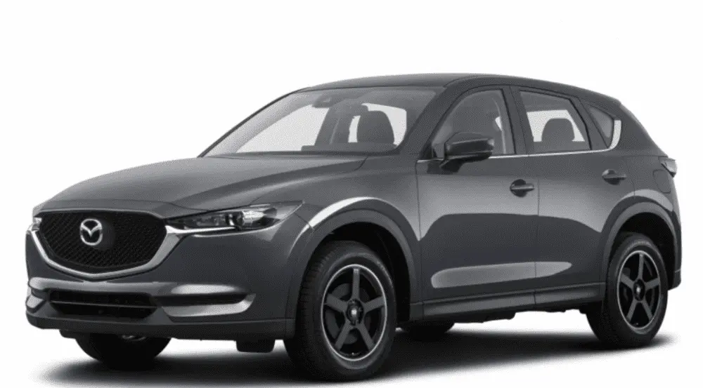

Ok. Think have decided the Montegi for the looks.
Its only low pressure cast(The BBS are pressure cast as well)
and not flow-formed like some of the Enkei wheels.
Will get me to 16 inch rim and lose weight.
The offset will go from stock 45 mm to 40 mm.
and it will change my track and scrub radius slightly
out from stock.
It is only a small change but has anyone run the
montegi(or other wheel) with 40 offset and how
is the performance/handling affected, if at all ??

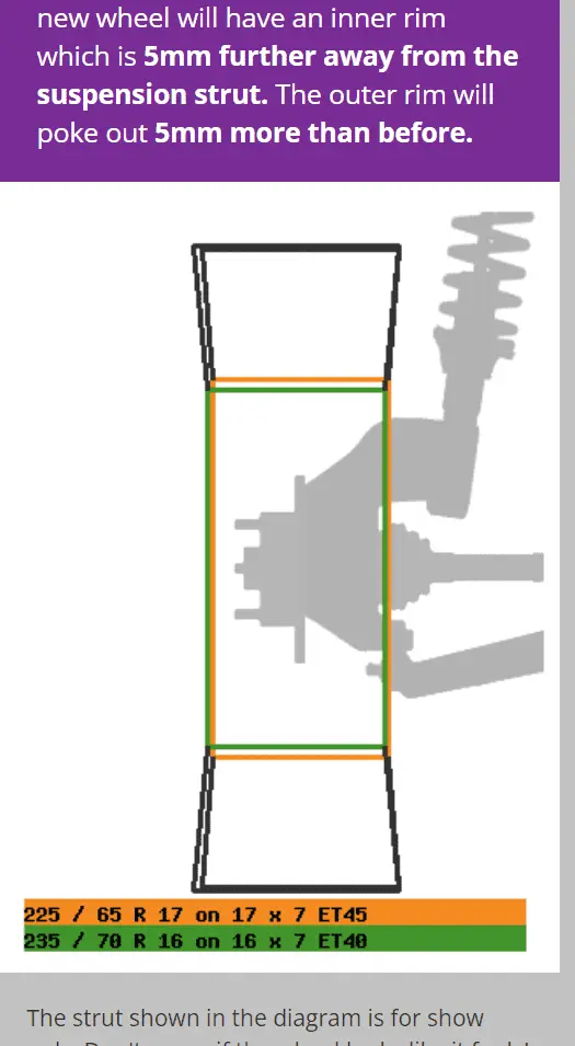

Below is the diagram of the difference.
Its only low pressure cast(The BBS are pressure cast as well) and not flow-formed like some of the Enkei wheels.
out from stock. Looks like it will change scrub radius by 3 mm. which will push the scrub by +3.
Does anyone know the mazda cx5 oem scrub radius andi f it's zero or negative ?

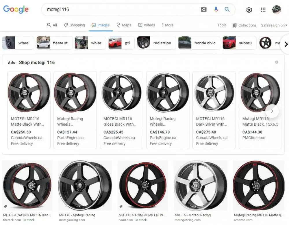

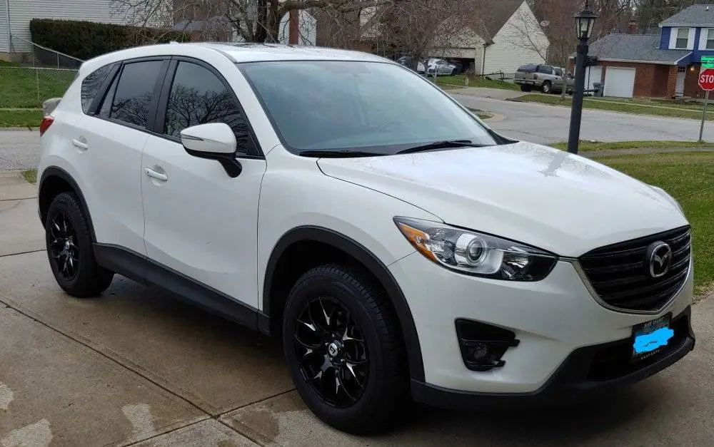

I think the Motegi look the best too, and also easiest to clean.
Yeah.. for those with soul red or white car, the Montegi with red strip looks really well. But the black goes better in the machine gray. The alutec 5 spoke grays we're a close 2nd.

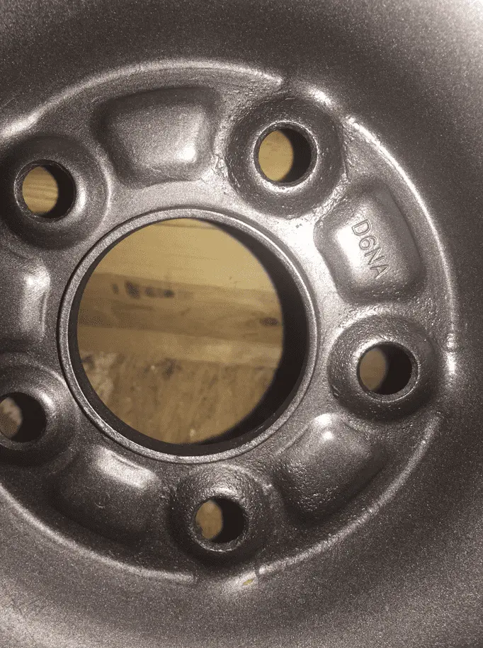

Okay looked all over the internet and looked all over the Mazda cx5 19" rim made in Japan... no rim max load rating anywhere on the rim unless I'm missing it.
So fast math, the gvwr = 4670 lbs. So each wheel needs to load at least 1168 lbs. bare minimum. So appears most of the konig, Montegi and Enkei wheels are load rated at at least 1500 lbs and up. Even the Enkei form flow has only a 1519 lb rating... seems a little low but ...
at least they appear to be more than adequate.
To be more accurate the front axle is approx 2400 and rear axle 2200. So the front would be about a 1200 load and rear 1100 load. Again fast math.
Still would be nice to know the OEM wheel load rate though.
The load rate in the Firestone tires will be 1984 lbs.. would be nice to have the rims rated close to that but it's only a cx5 daily driver so not gonna output that kinda $$$ for rims.
Upvote 0

Montegi 116 with ET40 for approx $520
BBS SR Grays ET 45 for approx $1150
Used Mazda Tribute ET 45 - approx $300
(Decent but still scuffed rims from junkyard)

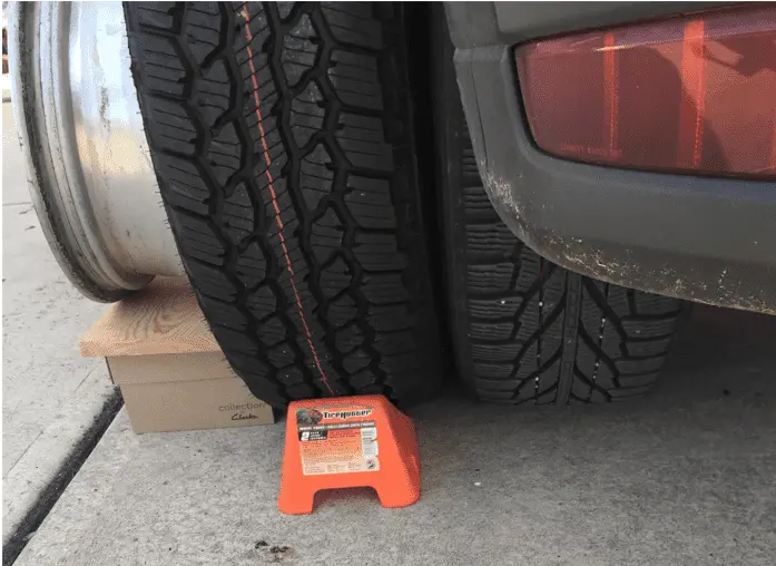

The Montegi's with ET40 and 235 70r16 tires will throw scrub radius off by + 3mm. Would have had to go to 245's to keep the OEM scrub radius but already bought tires and was tryin to keep the tire diameter near/close to OEM specs.
Am thinking of either going with the Montegi's for looks
or
just junkyard Mazda tribute rims for the OEM offset.
Attached are pictures of Montegi, BBS and Mazda Tribute rims
as well as the Firestone Destination AT2 tires showing the tread pattern.
Does anyone think the BBS rims look good enough to justify the price and keep the mazda oem offset?

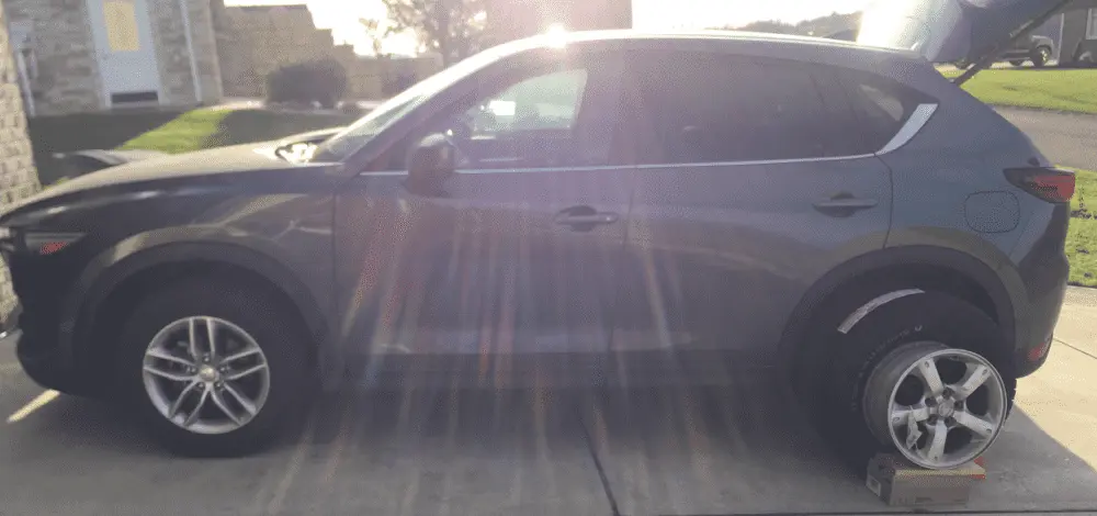

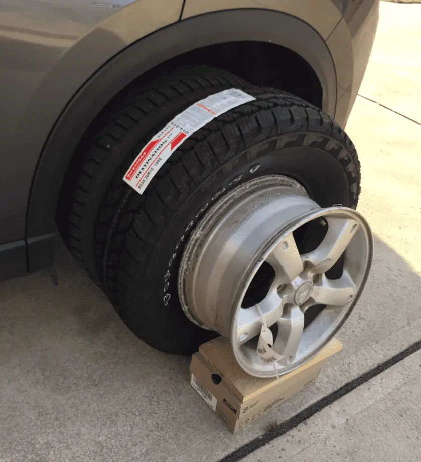

Just go with the Motegi wheels or the Tribute wheels. The Motegis have a nice, clean design, but the Tribute wheels look great for an OEM offering, and I think they look more "offroady" than the Motegis.
Upvote 0

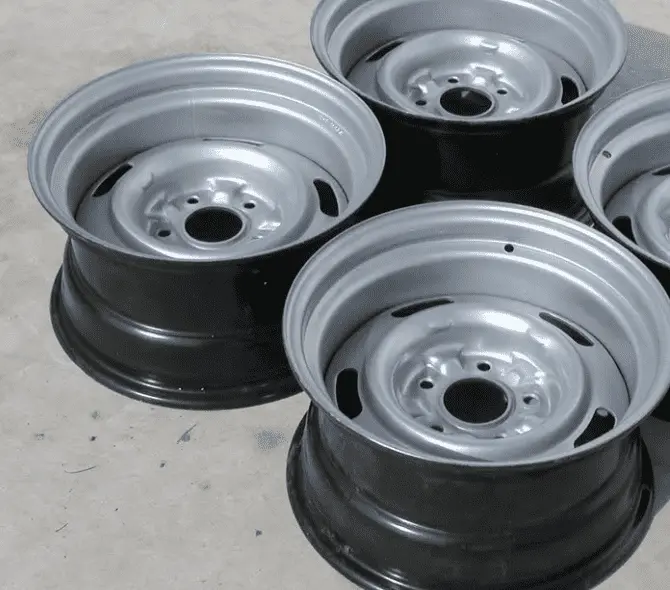

The prices I've paid for junkyard steel wheels has averaged around $15@.
Yeah steelies are cheap.
It's cost/benefit.

Ok, winter project, buy used alloys, degrease, strip, sand and paint them.
Am going to test one out that I have to see how looks
Paints narrowed down to :
Classic Argent Silver
Hammered Matte Black
Gunmetal Gray
Oil Rubbed Bronze
Not sure which one will go best with the machine gray
maybe the argent or the bronze ?
