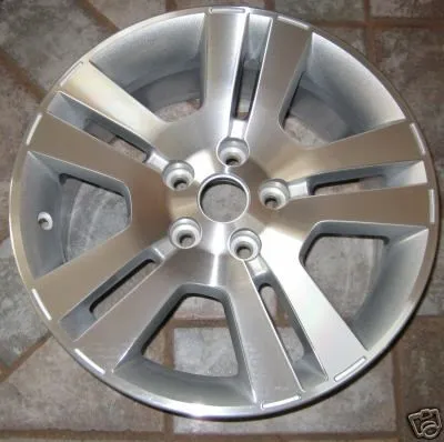

Long story short tire rack seems to keep delaying my winter setup that I had ordered from them so I am looking ofr alternatives on Ebay. Right now I am thinking of getting some ford fusion rims in 17x7.5 in a 44mm offset. I see a set of 4 for $300 so that looks about as cheap as I will get for winter wheels. I would have liked to go with 16s but I can't find any. So will the fusion wheels work on the MS3?

44mm offset shouldnt be a problem, but it will def be more of a squeeze than if the offset was a bit higher
Ok, the only thing I was worried about was since they are a half inch over stock width if the 44 would still be good. I might just go this route unless anyone can reccommend some good 16s that I could put on.

well, i wouldn't worry about the ford fusions if you're tossing snow tires on them. you would be using 215/50/17s, most likely, and 44mm offset should be enough for them! if you're REALLY paranoid, you can always go with 205/50/17 or something like that! =d
actually, i would check out what the center bore size on the fusion rims are. mazda requires very high bore sizes, so if that doesn't fit, you might have to go ghetto about things and have it bored out for you or something crazy...
I am scared to bore out any rims but I think ford and Mazda share the same center bores(it is rather large in comparison to other brands) and I think mitsubishi is the same as well.
i'm *almost* certain Fusion has the same center bore size as 3's, since all mazdas have the same bore size, and fusion is mechanically identical to the 6.
