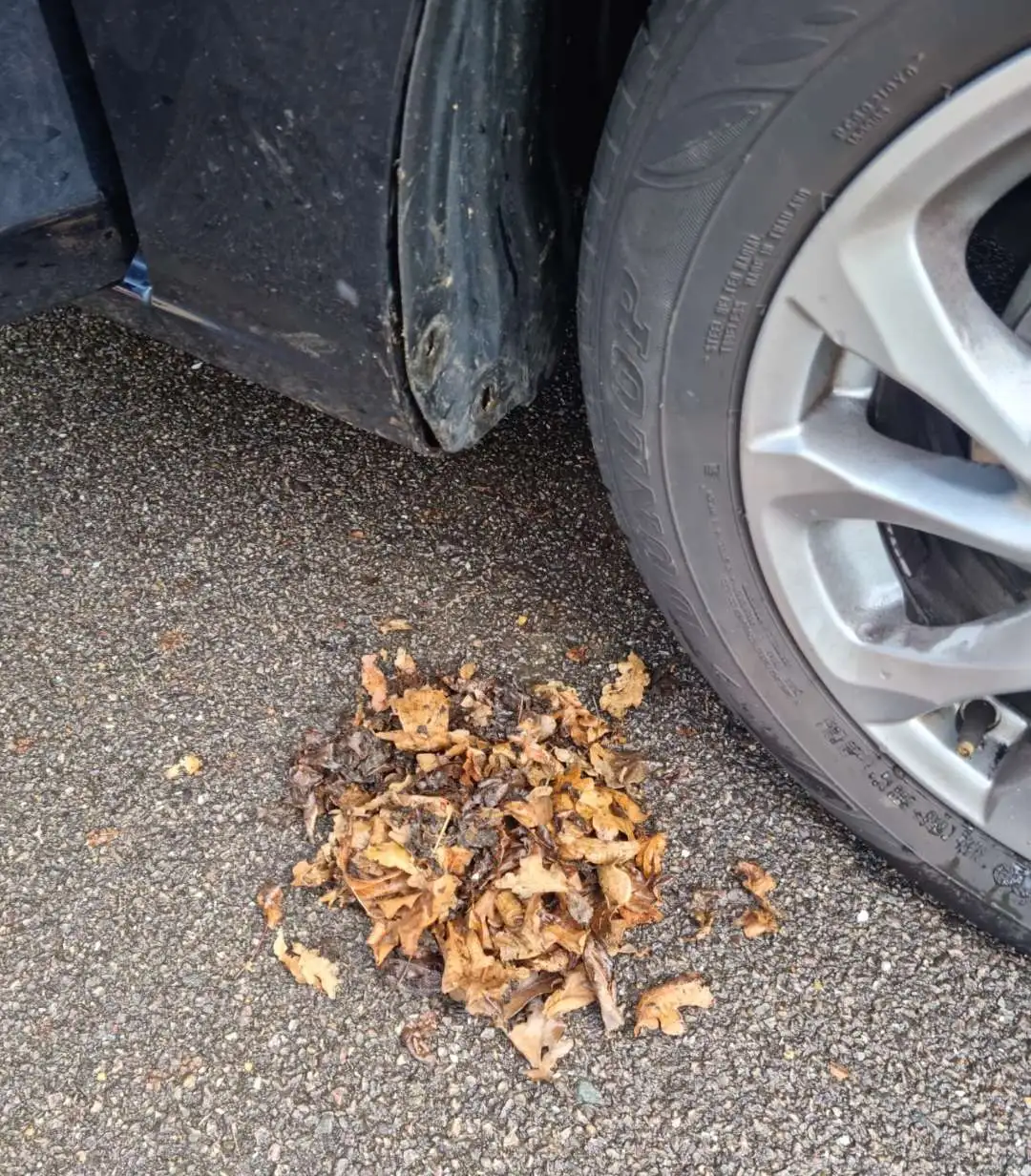

Had a clear out of leaves and debris from behind the front wings.

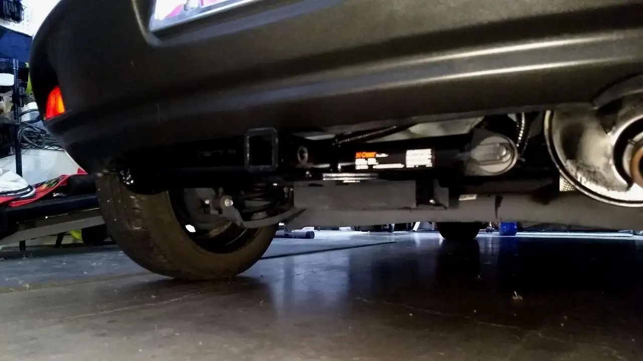

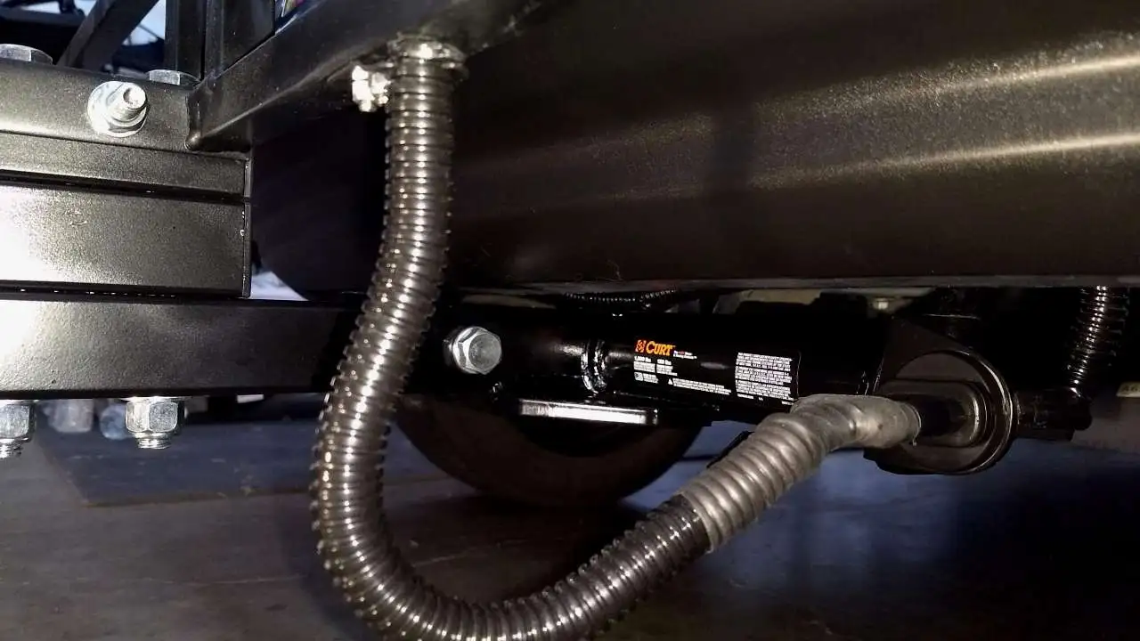

I installed a 1-1/4 receiver and a plug-and-play trailer lighting kit, and fabricated a custom bracket to hold a panel-mount lighting connector that bolts to the end of the receiver.

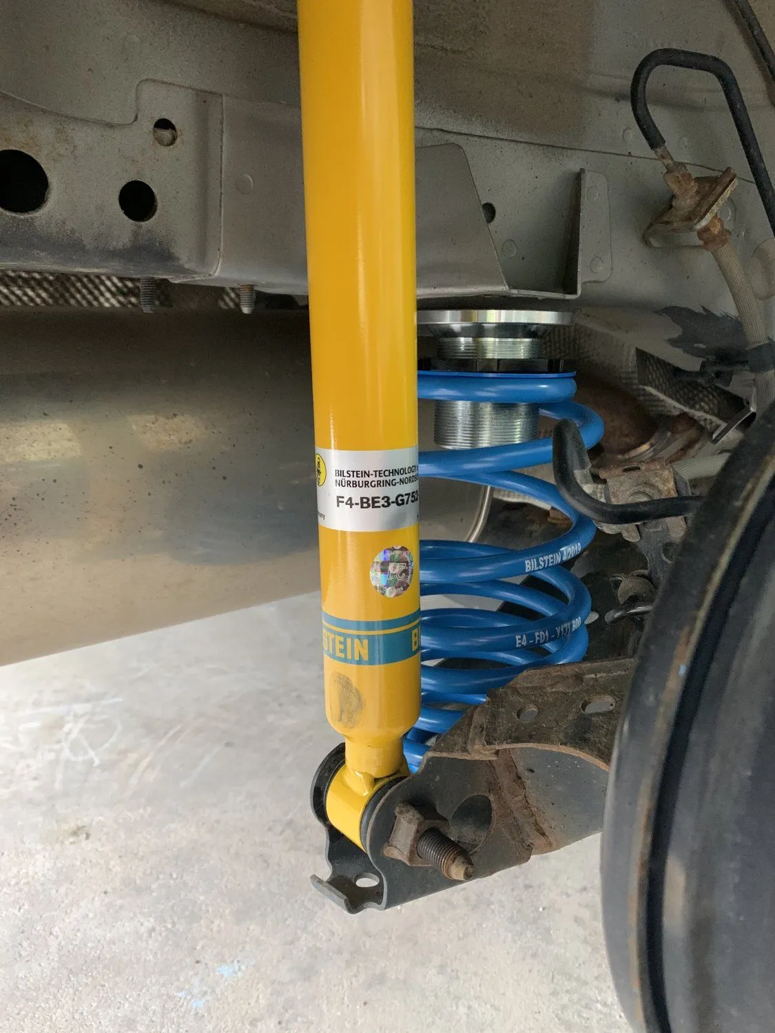

Installed new rear springs and shocks.
Now trying to remove the rear door panel...stuck at how to remove the door latch handle and lock (a 2012 2).
How did the spring replacement go? We need to do the same after new struts on the front.
Doesn't the rear handles come off the same as the front? Remove the middle cover with a thin plastic shim to expose the screw? Either that or it slides forward to release it from slots.
Straightforward enough...supported the vehicle weight on the jack locations and let the rear arms swing down and unload the springs....could remove the springs by hand. Used a spring compressor to reinstall, though maybe they could be levered into position.
I think a spring compressor is a must for the front struts, although I've never replaced those!
Appreciate the suggestion for the rear handles. Will give it a try.
I'm going to buy pre-assembled struts. There are other wear parts and it's a lot easier than piecing together old and new parts and trying to compress the spring.

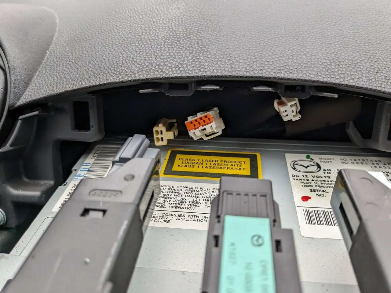

Tore apart the center console to fix the radio of a 2011 Mazda2 Yozora edition, as per this thread: 2011 Mazda2 Sport - No Sound from Speakers?
The soldering only took 5 minutes, but taking apart all the plastic covers and screws and putting it back together took hours. Sorry I didn't take any pics other than this one.

So I finally got around to buying a soldering iron and did what you suggested and it worked.
Thanks very much. Took me longer to pull the radio out and in than it did to run the soldering iron over the welds.
