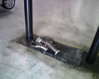

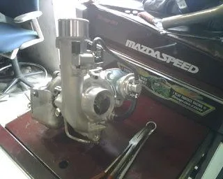

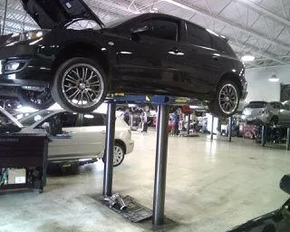

i went by to the dealership this morning and i snapped this pics as you can see ,for the doubters, the dp and rp on the floor, also its the same turbo the k0422 what they send as a replacement.
