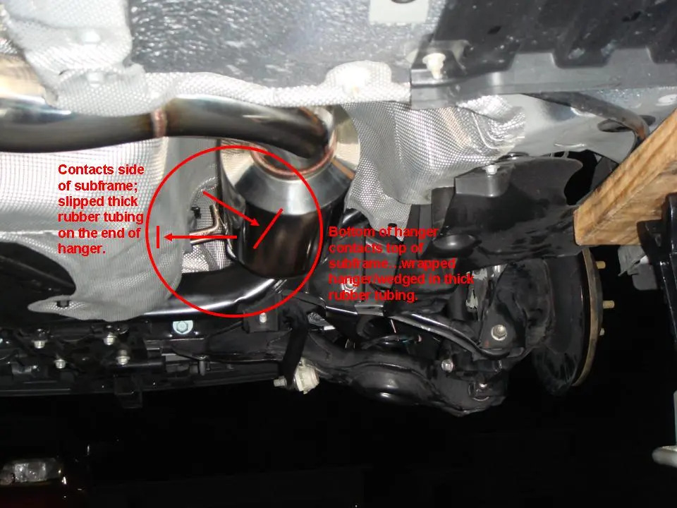

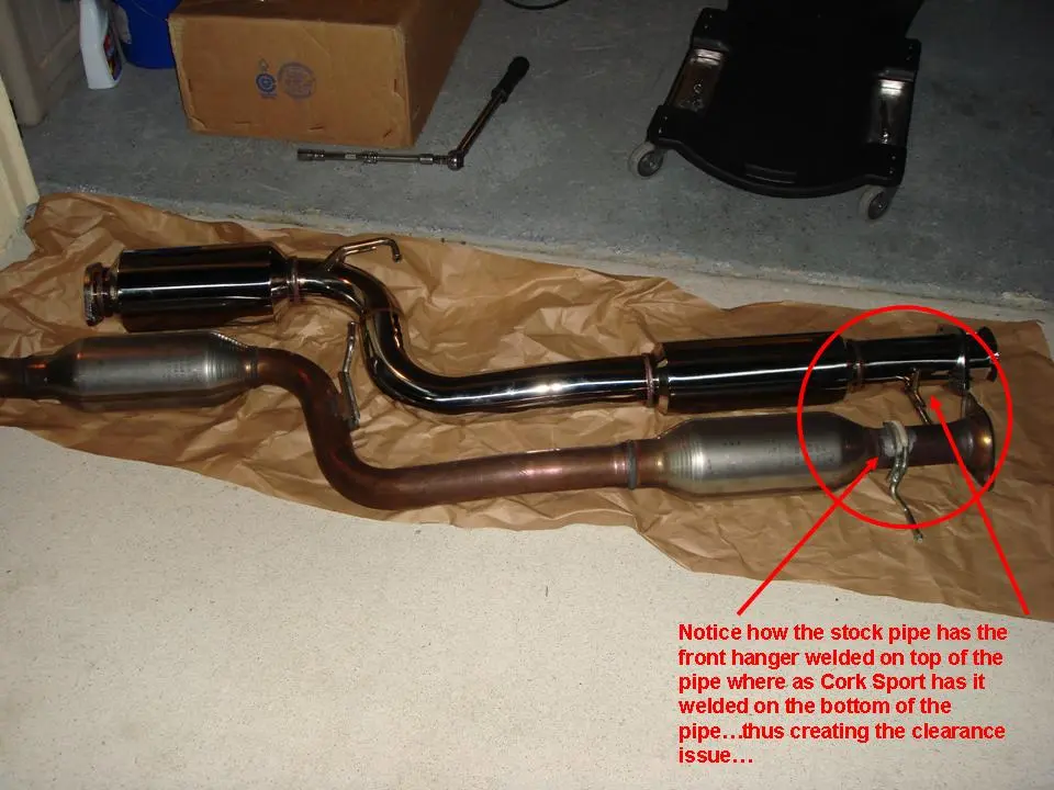

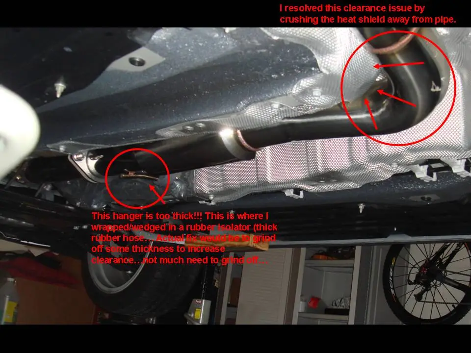

OK, here are some pictures and annotations to help everyone visualize the issues and what I did to resolve my clearance issues...
I will take new pictures of the final configuration as soon as I can...

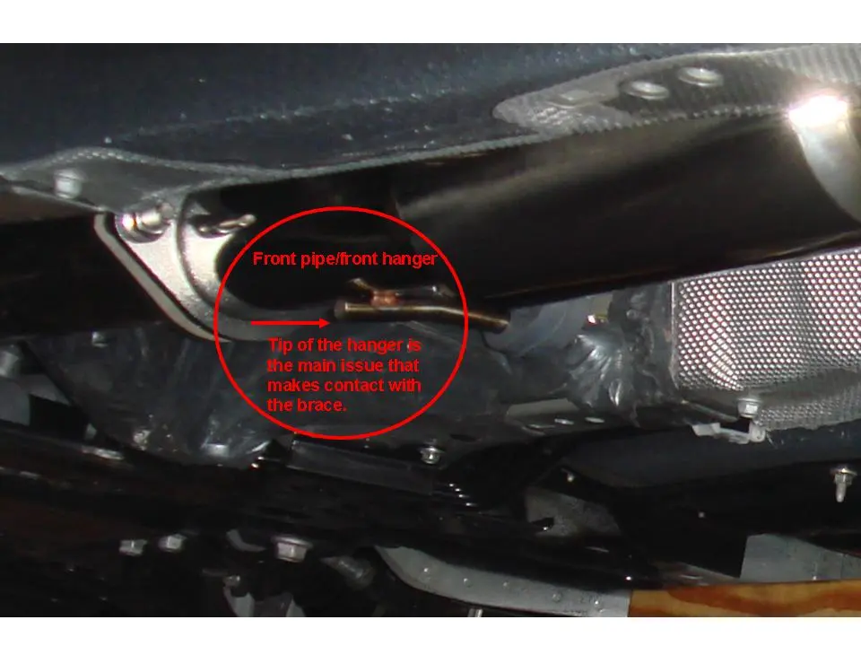

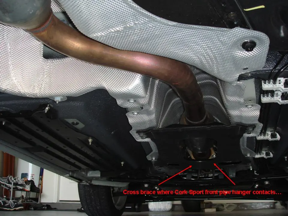

Here is a close up and clarification on the front harger issue.
Also, this is the exact same issue on the rear (subframe) lower contact issue. The tip of the lower hanger contacts the brace and the top of the rear subframe (rear subframe contact issue is with the rear pipe section).

weird, I never had any problems with that front hangar. Maybe has something to do with the fact you have the CPE DP and i am full corksport
Yea, the rubber hose or rubber nipple on the hanger was the same fix I used on my old car. Its not a big deal, but after a year or so, the rubber tube wore away in the long run, and I had to replace with it new a new rubber tube. Just keep some extra in the garage for future maintenance if you decide on this method as your fix.

Thanks for pictures and and help for the folks with rattles. As I said somewhere, Cork inserts and moving hangars as suggested did it for me. Thanks guys
I got a call from Cork... Seems like my exhaust sneaked out the door without being finished... They told me to cut 1/4" - 1/2" off the rear (subframe) hanger.
Regarding the front hanger contacting the cross brace, there is like a 1/4" protrusion from the weld joint that needs to be grinded off...
These were issues with my CBE I got...according to Cork Sport, my exhaust should have left the shop without these issues.
Oh well...
