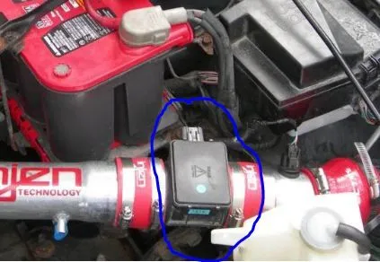

The MAF is the flat rectangular box mounted just before the filter box with a 3 wire electrical plug connected to it. The MAF housing also has a square screen to direct laminar air over the sensor. It isn't something that would be easy to make from scratch.

Yeah, except there are dry rot cracks in mine between the ridges in the accordion part of the tube. I have read on here recently a bunch of people have been tracing idling and surging problems to that. So I have to replace mine.
This is the MAF housing I'm talking about.
attachment.php
Looks like this guy just used the old one. That answers that question.
