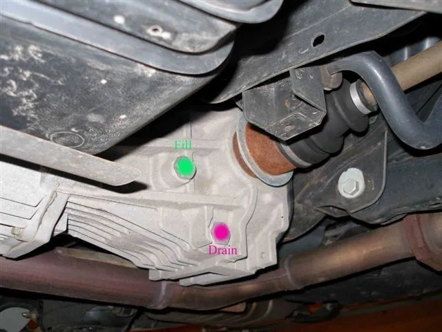

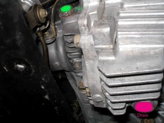

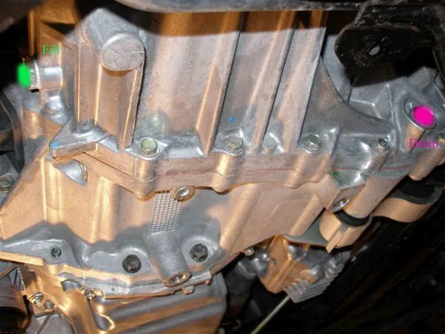

Hey does anyone know which bolts are the drain and fill plugs on the transmission on the speed 6, ive heard of alot of u guys running the MT-90 fluid and i bought some and its due in tomorrow.. i was wondering if any of the guys who have put this in could help me out...if so then im going to put a thread in the how to section about how to change ur transmission fluid since up to the date its not in there and id be glad to do a write up on it..thanks guys.
Attached are pictures of the transmission, transfer case (PTO), and rear differential.
Make sure you take off the fill bolt first. (Highest bolt)
I believe the transmission bolts are 23mm. The drain plug on the transmission requires the use of a box wrench.

ok i got it and marked both of them...these part numbers ur giving me...can i purchase the gaskets at autozone or? thanks for the help once im done with this whole thing ill be post a how to on it.
The part numbers are Mazda part numbers. You have to get them at a Mazda dealer.
the transmission drain and fill plugs are 24mm. and it came out great..im doing a write up in how to tonight.
