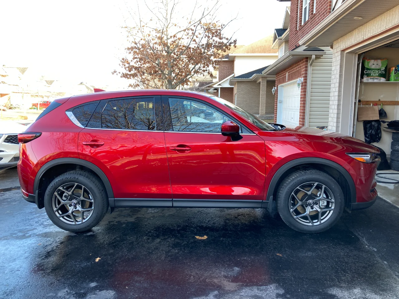

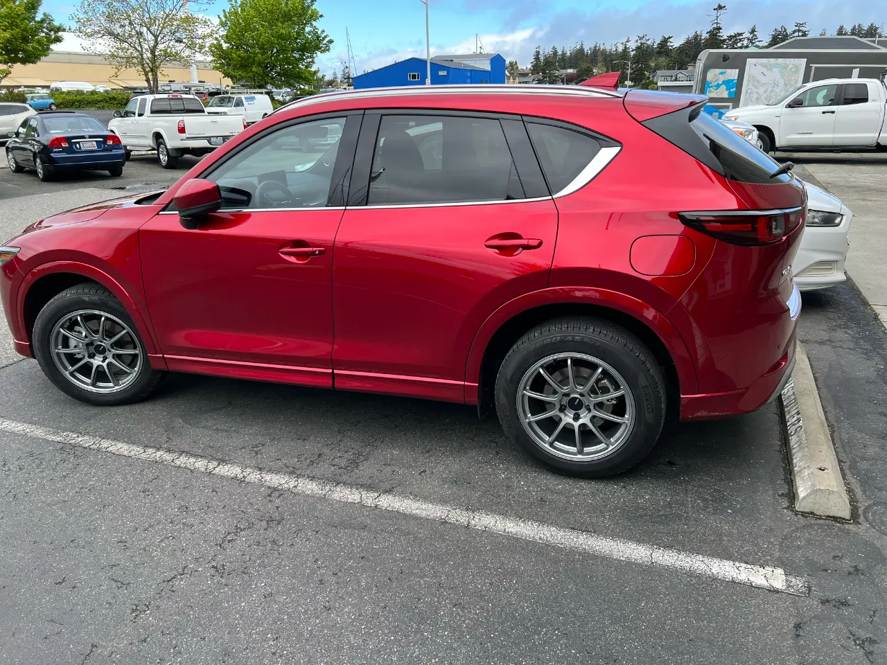

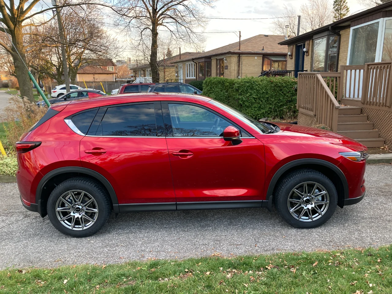

I have 18" rims for both winter and summer sets. I sold the 19" OEM wheels and tires. The 18"s ride well, no issues.
Winter: 18x8.0 ET+45 with 225/60-18 tires
Summer: 18x8.0 ET+45 with 245/55-18 tires

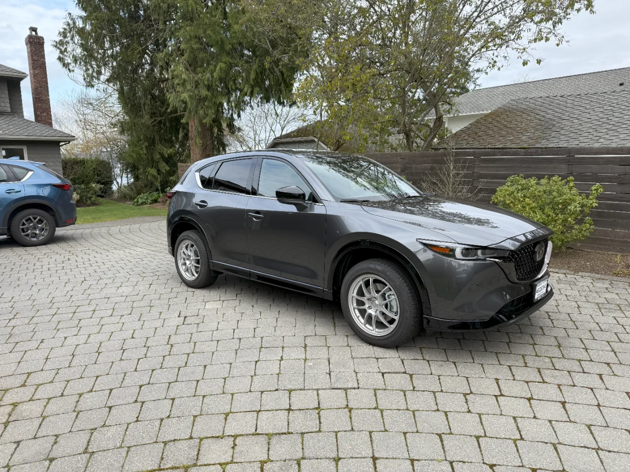

I did the Pirelli P Zero AS+3 / Enkei Triumph.
Steering is much less heavy and is more accurate.
Ride is just slightly less cushy than the Goodyears (great riding tires).
Handling is very nice.
