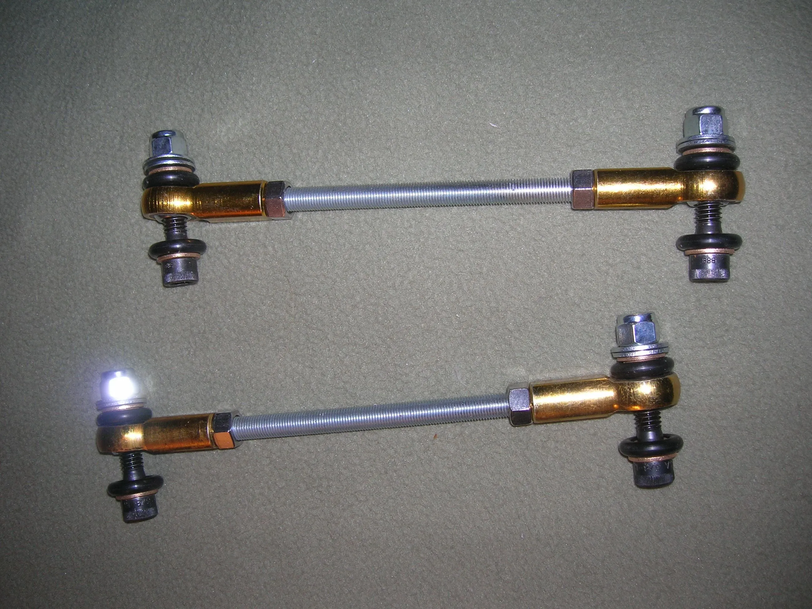

Fan-fing-tastic. Hotcarl has them on the front and didn't mention them creating any noises. What are my other options?
As if you could hear the front ones wih all the other noisy s*** these cars do lol.
The custom route is there. Pretty cheap from mcmaster. Just buy some balljoint rod ends and cut rod to length.
Some have used the oil impregnated ones, i just use the carbon reinorced ptfe ones that dont need lube.
Little bit of clunk but no worse than any other poly suspension bit.
I was out of town for the past week and the car was amazingly quiet today, except for the faint pulse during low speeds I am hearing from what I presume is a bad wheel bearing.
End links aren't here yet, but now I am debating whether to just send them back. I'll end up eating $50 in restocking fee so I am pretty pissed about that.
"Just buy some balljoint rod ends and cut rod to length?" Where do I buy these? The endlinks actually need to be longer, not shorter. I always assumed adjustables were threaded so you could tighten or loosen the bolt to the desired length.
I found these through some forum posts.
http://racinglineperformance.com/shop/pc/viewCategories.asp?idCategory=16
They appear much higher quality than the AWR links.
So I got Ken to cancel my AWR endlinks order. But racingline's site says they are out of stock. They only have an e-mail contact form, which is always a black hole with these sites. Anyone have a number for them (although it'll be intl from the states I guess)? I used the form on Monday and haven't heard a response.
I really don't want to put homemade parts on my car, but it looks like the best option at this point. Hell of a lot cheaper at least.
Endlinks are pretty simple. And all the awr is, is a machine rod which isnt really different than threaded rod. They use very similar balljoints to what mcmaster sells and you adjust them the same way.
They make these balljoints or everything from light tooling stuff up o aircraft grade so they are plenty strong to hold a bar to a strut.
But if your worried id have just got the awrs
I wouldn't worry at all about "homemade parts" on your car, at least not the endlinks... I can assure you that the threaded rod is more than strong enough to take the loading without buckling. When I made mine I changed a few things to make them "better" or at least what I would consider better.
First, instead of spacing out the endlink with washers and relying on the o-ring for spacing, I used flanged bronze bushings and with larger o-rings. McMaster # 6338K414 Bronze bushings (SAE 841) and standard Buna-N #310 o-rings.
Second, there is no need to use grade 8 bolts on the end, or fine threaded bolts unless you have them around. The threaded rod does have to be fine thread, but the bolts do not. You will note that I used socket head bolts, this is just because I had them lying around; I would recommend hex head, grade 5 if you are worried.
Now I didn't do the math and calculate critical buckling loads for the components, but if it makes you feel better I can. Also, if you are wondering by what authority I make these claims, I am a mechanical engineer.
Here is a picture of how mine ended up.
my links are the same but i use 2.5" bolts with teflon sleeves to space the ball-joint from the bar/strut. i also use lock washers to firmly anchor the seperate ends of the link so the only thing that moves is the ball in the joint. orings would wear out.
