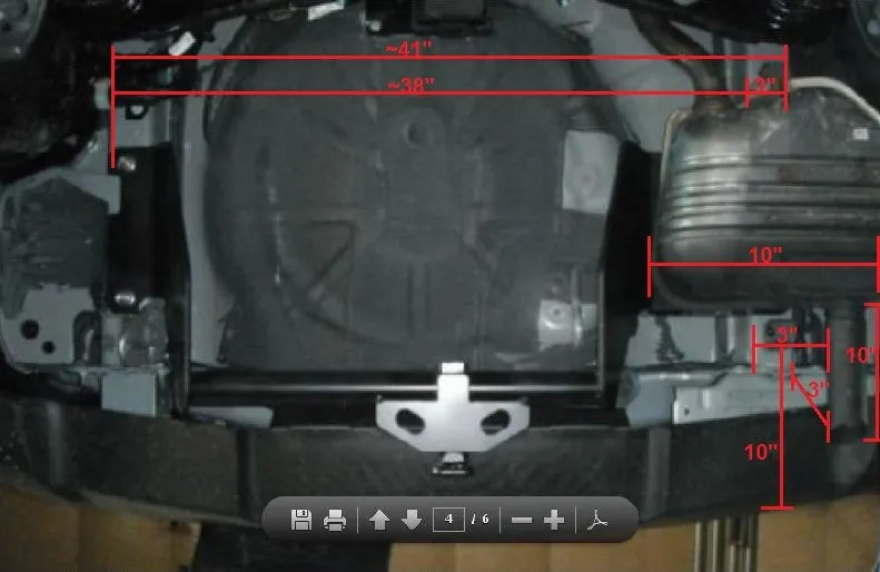

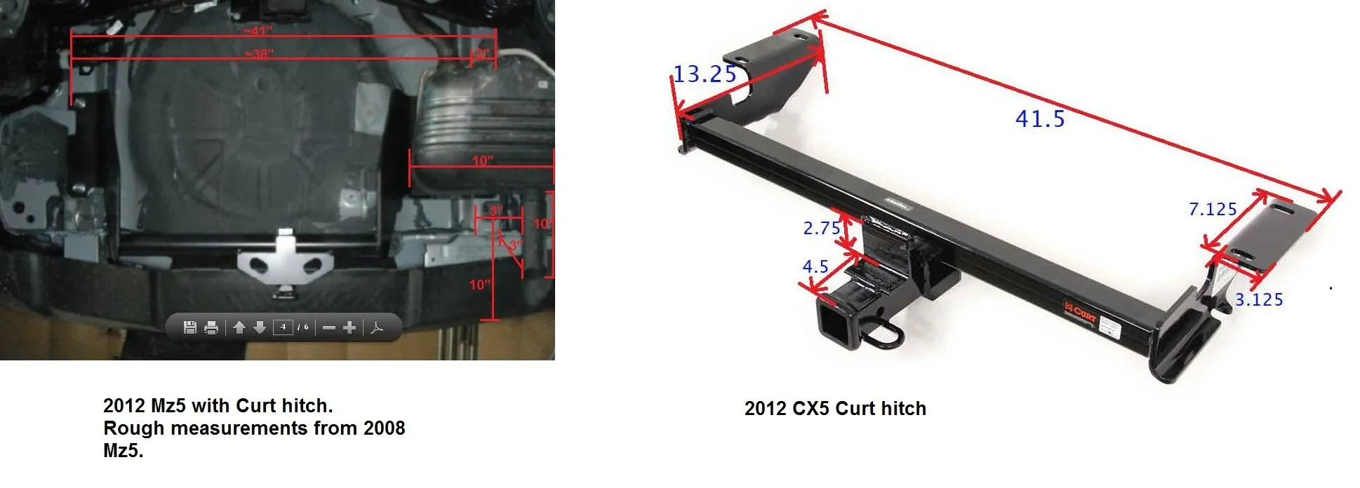

Another option is the CX5 Curt Class 3 (NOTE IT HAS CLASS 2 LIMITS, with a 2 receiver so it's not a true class 3!) or Reese Multi-fit (Im not a fan of Reese quality but these things are class 3&4). Ive looked under the car and took some VERY rough measurements and it seems a CX5 hitch may technically fit but may require drilling a hole (could not confirm). BUT, the issue is with our muffler. It rests directly under the unibody support beam so theres no clearance to mount the hitch to the beam. The CX5 has a center mount exhaust with dual tips so theres clearance on both sides. Assumption, this may partly explain why only light weight hitches are available for passenger cars as the muffler always gets in the way (from the hitch manufacturer stand point, not talking about the cars limitations). However, CX5 hitch may be plausible IF you also opt for a smaller diameter muffler. Going with a 7 oval universal just might provide the clearance on the inner beam to mount one of these! The 5 round universal will definitely provide the clearance. Assumption, I think the center mount dual exhaust from the 2.5 CX5/Mz3 should fit with some minor modifications (cut bumper + welding hanger +?) since the newer 2.5L Mz3 come with this type of setup. If going this route, there are aftermarket options from Racing Beat but Im interested in going there.
CX5 hitch. Yes, I realize there are other userful measurements I could and should have asked for.
http://www.mazdas247.com/forum/show...Measurement-Request-for-Curt-Hitch&highlight=
Underside of 2012 with curt hitch and ROUGH measurements from an '08. If someone here has or can get a 2012 Curt hitch and take the same measurements as the CX5 hitch, we'll know if they use the same mounts -or not. Seems pretty close to me

So I’ve done some research/measurements/experimenting b/c I realllllly want a 2” receiver. I don’t believe in limiting myself if there is the potential for a better option. It’s not just the opening that I want, I also want it to be capable.
I was really optimistic that CX5 class 3 (rated for Class 2 limits!) would fit b/c it is based on the same unibody chassis as the Mz3/Mz5 but with a “strengthen rear end” per some publication I previously read. I wanted to try it but don’t want to pay shipping/restocking fees and can’t just go pick one up to try. I had to think outside of the box. While doing art with the kids I had an Aha! moment. We had some large cardboard boxes needing to recycle so I figure why not just make one to simulate a test fit! I have measurements thanks to a CX5 member! It was pretty easy and a fun way to spend some time measuring, cutting, and taping. The replica is not 100% to scale but I tried my best to replicate it.
In summary….. I can officially say there is no freaking way it can fit. The mounting holes do not align, the mounting plate do not seat flush b/c the Mz5 horizon beam has odd patch weld for some kind of support, the bend in the hitch arms hit the bumper reinforcement beam, the cross section gets in the way of the rear tow hook, and finally the receiver is about 2-3” too low sticking out like a sore thumb. At least I have closure.
