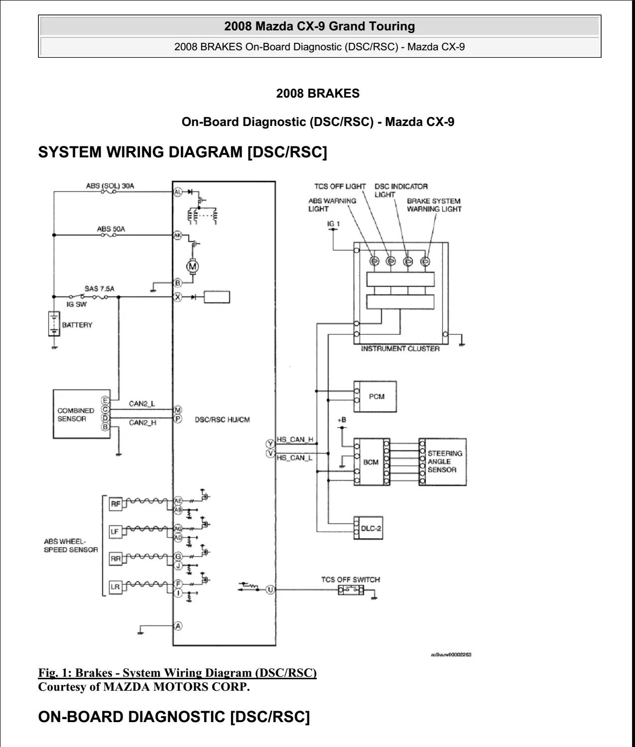

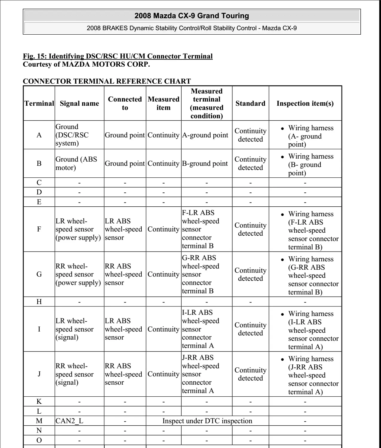

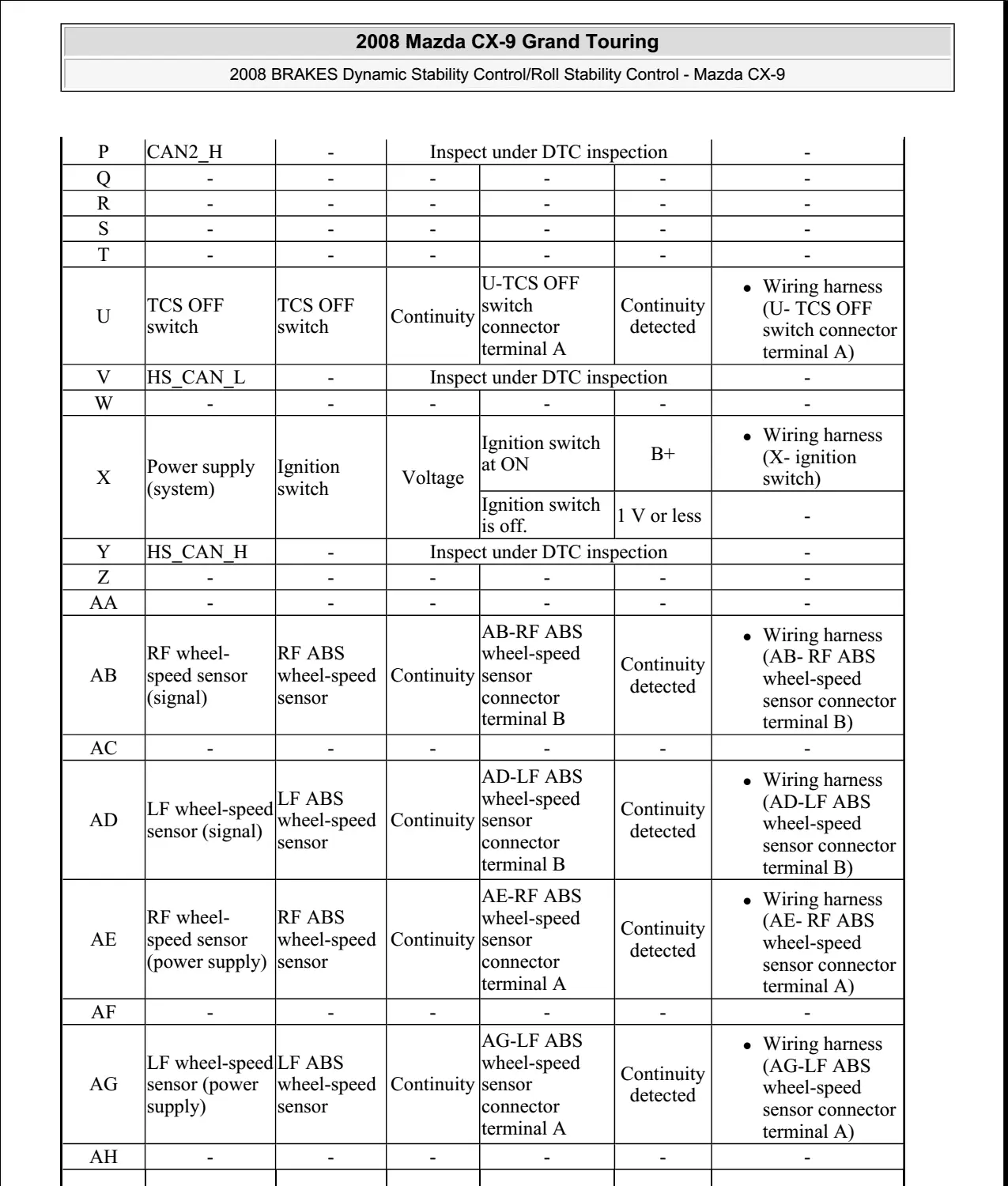

There appears to be an open circuit in the DSC/RSC system wiring. I've looked at the workshop manual but can't clearly understand the instructions shown in the attachment.
Can someone please take a look and let me know how I should go about testing for continuity?
If I want to test the continuity in LR speed sensor, should I connect one of the multimeter leads to terminal F and the other to terminal B?
To do an ohm reading on the LR ABS sensor, should I connect the leads to terminals F and I ?
Besides disconnecting the battery, any other precautions I need to take?
This chart is not perfectly clear to me. It would be nice to have a wiring schematic, as well. You would not typically check signal or power wires to ground unless you are measuring voltage.
I've attached the wiring diagram.
In case of the ohm reading, would connecting the multimeter leads to terminals G and J, or F and I work?
