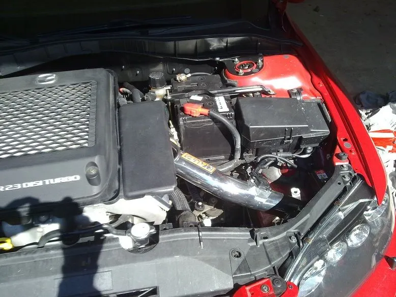

I recommend you check the fujita air filter to make sure it isn't too far up on the pipe.

I will check filter, it might be too far up on pipe.
Thnx

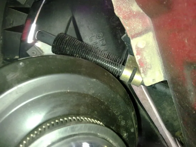

When I was installing fujita air filter i couldnt put it on the botom of the pipe becoase down under is some kind of oil cooler for servo i think (on attached image).
I managed today to put filter 3 inches lower, but it is now very near to the oil cooler.

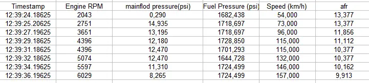

I will also attach some datalog from today in 4th gear but only with low sample per second.
I hit solid 15 psi at 2800rpm (spike 16-17), and then went slowly down, but much better than before.
Air temerature was 50 F, and clear weather.

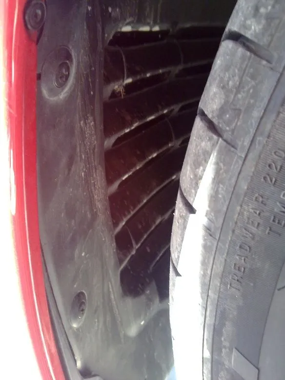

And for my cai I made self some hydroshield (saw on forum similar) from water repellent textile and placed it between tyre and air filter to close air inlets for stock intake (picture). Is this ok, or should I buy injen hydroshield?

if you had to move the filter down 3" inches that is quite substantial and i can see why you weren't boosting correctly. with the fujita you need to make sure that pipe does not go past the collar like others have said, since this will hurt the airflow. i've run the fujita before and its not a bad intake just need to make sure its installed correctly.
