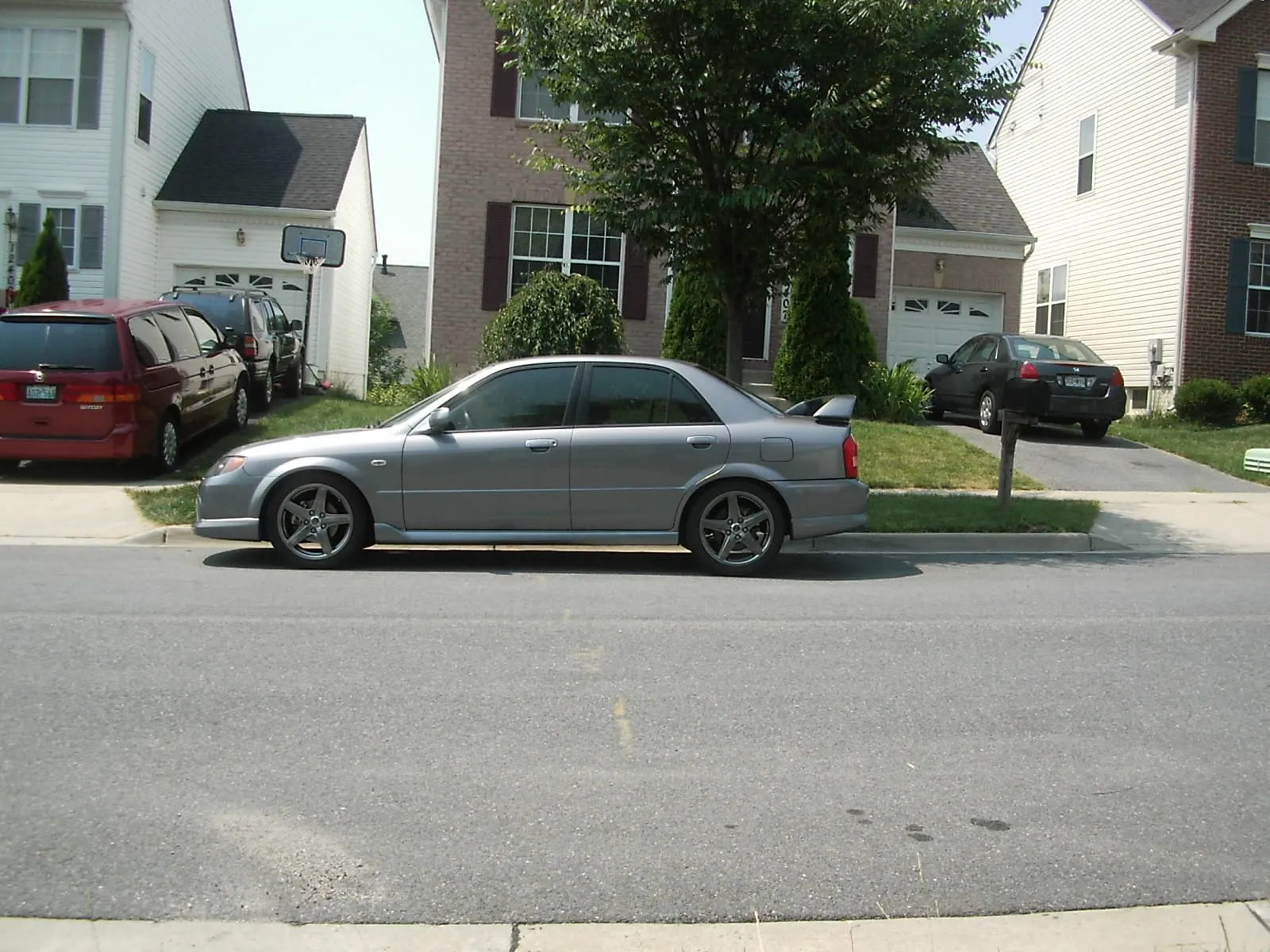

here is what the falkens look like on an msp if anyone is wondering
