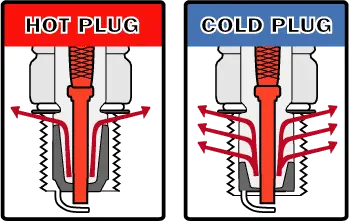

These arrows are supposed to represent......?
heat escaping...more arrows= more heat escaping= colder plug
and i don't think it's so much that it cools the combustion chamber as it does prevents the plug itself from being the "hotspot" in the chamber.
since less of the porcelein is exposed in the combustion chamber on the cold plug the heat can escape the plug through the head easier/quicker.
